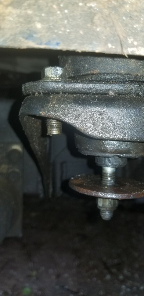

Hey yall,
I'm getting a loud clunking noise in my 1993 pickup when I am going over any uneven terrain. I believe the problem is the bushing I attached pictures of. The truck has a 3 inch body lift.
I'm looking for suggestions on where to buy them and if anyone has replaced them before and can share there experience before I get into it. Seems like it shouldn't be to much of a pain.

my professional recommendations is that the amount of body lift you install directly correlates to how much axe body spray you use throughout the day. 0-1" is none, anything over that is 8 cans. ditch the 3" body lift and make Toyotas great again. you can get great new poly bushing sets from energysuspension for about 100 bucks, or you can get a good custom kit from 4Crawler with new hardware for a little more. I have run 2 kits from 4crawler and his stuff is top notch.

4Crawler?
https://www.4crawler.com/4x4/ForSale...l#PolyBushings

Eventually I will be getting into the suspension but funds will be holding that off for a bit. I think I will just order the bushings from 4crawler for now.

you can specify on his site what length bushings, he will cut any length you want. you can also ask for hardware or upgraded hardware. read carefully the site isn't the most up to date thing in the world.

So I got the bushings and hardware quickly. Everything looks good. I'm fighting a couple of bolts though and I was wondering if yall had any advice on getting them out.
It's the bolts on the front cab body mounts holding the bracket to the frame. I cant get a socket on them and a open end wrench barely holds. Worried about rounding them. Since I have new bushings can I just get it red hot and hopefully its loose enough to twist out of there??

I think you don't need to remove the bolt in the left.
The procedure is similar like in this video (but no lift of course), I believe:
But lets wait for the experts advice.

I think its different. The set of bushing I got came with a replacement bracket also. I just cant get a wrench or socket on the nut because how close it is to the lift block. Might try grinding down a socket and see if I can get it on there.
