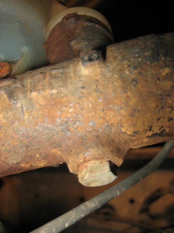

According to the FSM, there's supposed to be a bleeder plug on the clutch release cylinder. I couldn't find a bleeder plug that looks like the images in the FSM or Haynes manual. Here are a few pictures of my master cylinder:

Bolt on the bottom of the master cylinder:

I loosened the bolt on the bottom of the master cylinder because I couldn't find a "bleed plug" as described. Then I had a friend pump the clutch a few times with the bolt loosened, making sure to tighten it up after each full extension, then loosen, then tighten, etc. It made a noticeable difference after draining approximately 1/4 of the reservoir. My clutch was still a little bit mushy, but far improved.
The question is, do I use this bolt as the "bleed plug", or is there an actual nipple that I can hook a hose up to on either the master/slave cylinders, and if so, where is that located?

The bleeder plug is on the slave which is on the side of the transmission. There are two master cylinders, one brake, and one clutch. The smaller one is the clutch, and if you follow that line it should lead you right to the clutch slave.

The first two pics you posted are the brake master cylinder. The third one is the clutch master cylinder. Like turboboost said, the clutch slave cylinder is on the side of the transmission, specifically on the side of the bell housing and you can find it by following the steel line from the clutch master cylinder.

Passenger side of the transmission, in fact. Look for the clutch release fork sticking out of the bellhousing. It has a rubber boot. The clutch slave cylinder engages that.
I don't know exactly how your clutch improved after you messed with the brake master cylinder considering they are not connected in any way, shape, or form to each other. Hydraulic pressure build up in the same way you'd pump the brakes when there is air in the lines, is all I can figure. I will say if your brake fluid (in the brake master cylinder) looks dark (because it kinda does in the pic), you might consider flushing your brake system. That means there is gunk also throughout the lines, calipers, wheel cylinders, and proportioning valve. Typically, this should atleast be done once a year depending on enviroment and driving conditions. Moisture builds up in the system and corrosion begins to occur..........hence the darkening of the fluid.
