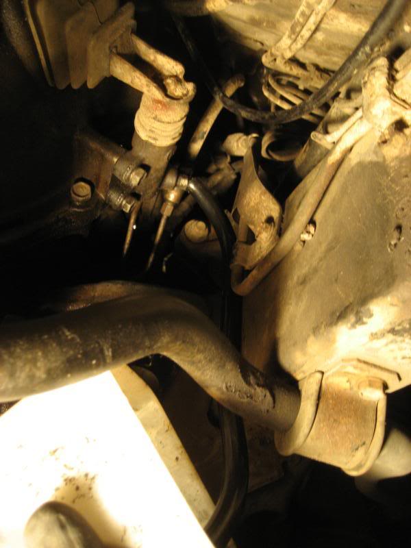

Monochrome 10-29-2009 03:15 PM
1 Attachment(s)
I figured I should resolve this thread. I was able to successfully bleed the clutch the other night with the help of a friend, this time in the right location. :) The fluid was dark green, so flushed it all out and replaced it with some new synthetic DOT 3. Got rid of all the bubbles. Did 4 or 5 more cycles after bubbles stopped coming out, so I assume the system was bled successfully. Might have been overkill, but I wanted to do it right!! The clutch definitely feels much better now -- it is fully disengaging.
Only one issue remains: there is still some notchiness in shifting from 1st --> 2nd, and a little bit from 2nd --> 3rd. It's difficult to downshift while moving above 5mph from 2nd --> 1st, I have to practically force the stick to do that. Would that be the synchros?
This is my ghetto drain job using some spare high pressure hose and a paint mixing cup:
Attachment 185147
