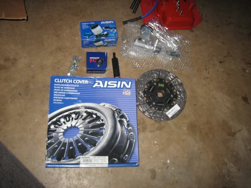

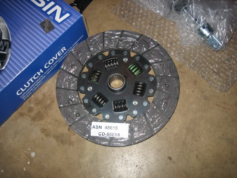

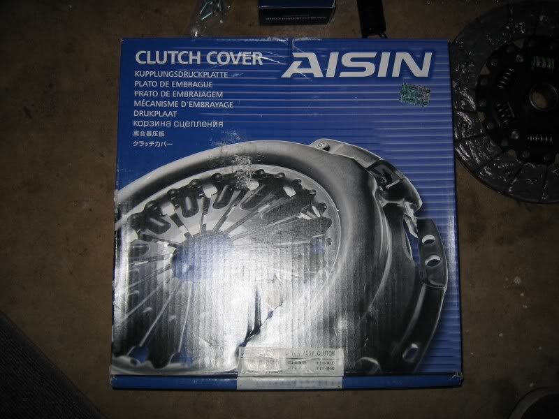

so I have received the wrong clutch from MC...
everything was going smoothly; popped the old pilot bearing out, popped the new one in, put on the new flywheel and locktited and torqued the bolts, and then went to line up the new disc and pressure plate, and yeah, it's too big...
now ACCORDING TO MC's WEB SITE, THIS IS THE CORRECT CLUTCH FOR MY TRUCK... it obviously isn't... the pins will not even come CLOSE to lining up on the flywheel...

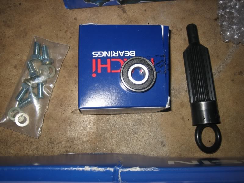

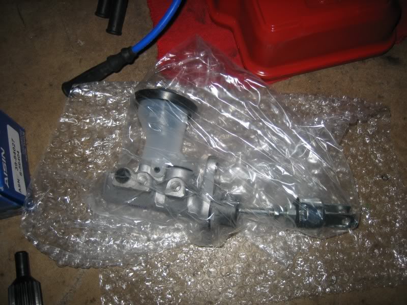

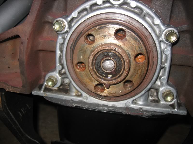

what the hell, why not... pics from the LITTLE BIT of progress I could make today:
well first, the MC order with the incorrect clutch disc and pressure plate
at least everything else was right

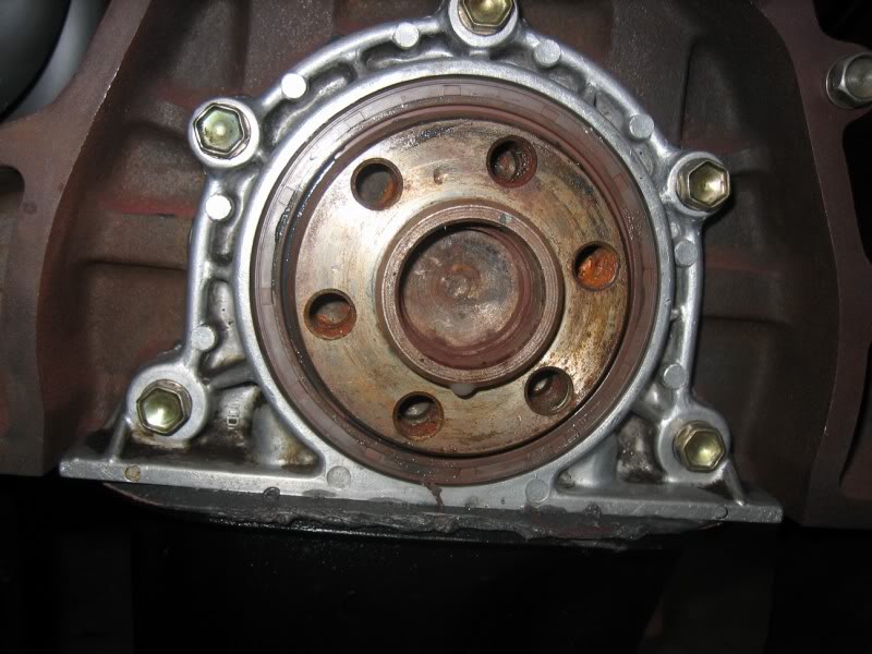

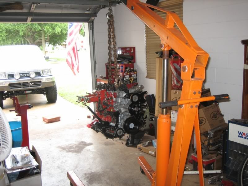

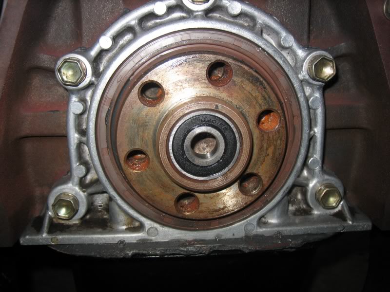

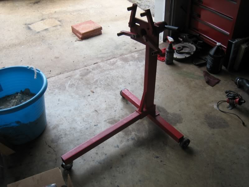

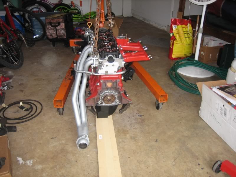

Got the motor into a position to work on the rear of it
I'll tell ya what, that engine stand's a lot easier to wheel around with nothing on it, lol

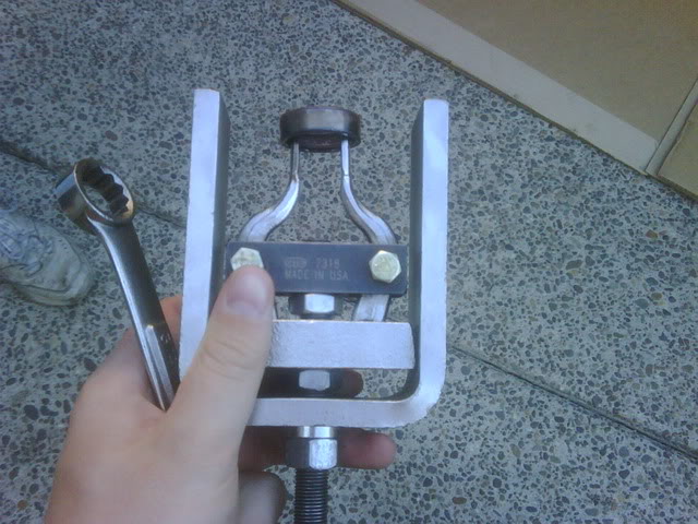

got the old pilot bearing out: video soon to come for that; I'm thinking about posting an instructional how-to on removing the pilot bearing easily

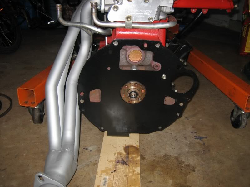

and popped the new one in
and bolted on the "pretty-plate"
followed by the new flywheel, torqed to 80ft/lbs and locktited

Looks like a new rear main seal too?
Oh yea, that number on the clutch disk, thats the same number i had on my 1200ft lb one for my 3vz with the R150 tranny. Dont know if it will help but there ya go haha.

Would your pilot bearing removal technique have anything to do with wheel bearing grease?
Old Jul 8, 2009 | 05:52 PM

...or a candle?
Old Jul 8, 2009 | 06:07 PM
  #616
iamsuperbleeder's Avatar
Joined: Feb 2008
Posts: 12,248
Likes: 33
From: Lake City, Fl
wet paper actually
I'm working on a how-to video right now
