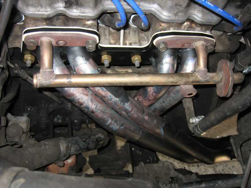

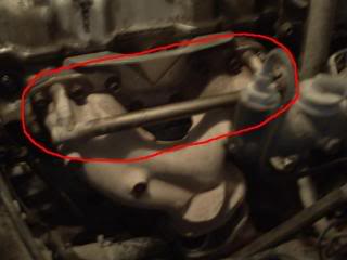

hey for your after market headers what all did you have to do with this thing
no I use to have it installed with the header before the rebuild:
I'm just blocking it off as part of the doing away with the emissions junk during the rebuild
