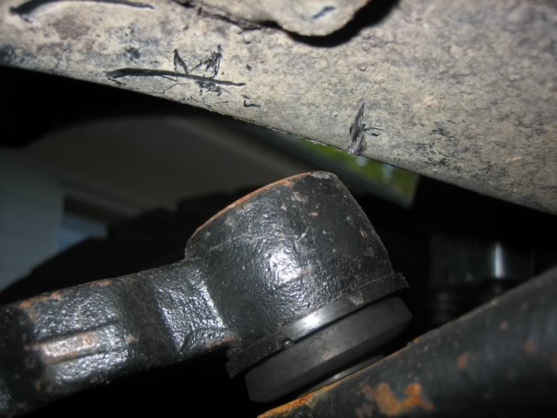

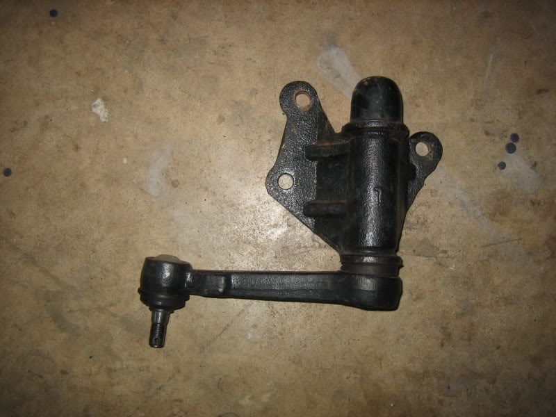

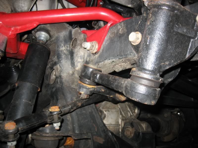

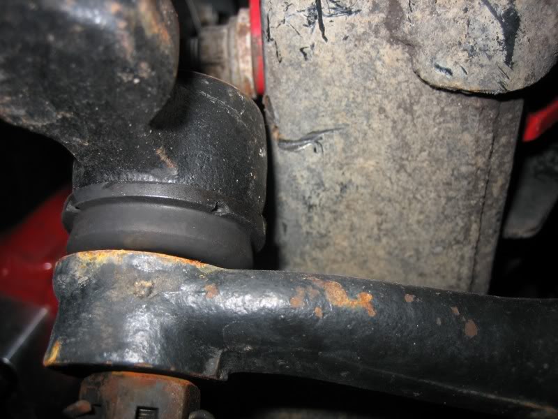

found the first problem today, but not with the engine
remember I said I'd need an idler arm brace soon with the new suspention setup? well I didn't think it would be THIS soon
I went to pull out of my drive way, and I turned the wheel and heard a "POP"... all I could think was "wth?". So I cylced the wheel side to side a few times, and it would do it every time... I got to looking around looking for rub marks, and I found the culprit
not really a HUGE issue... I quick run up to the parts store, and $90 later, I had a replacment to bolt on, lol. Not the design that'll take the brace unfortunately
but I think the reason the old one bent so fast was the ride without the aligment, and the toe facing in put a bunch of pressure on it...
I took it down to have it aligned today, and got the dumbest freek'n guy there to work on the thing
But I know a guy that works there; he use to be a regular customer of mine back when I worked at Advance Auto Parts, and he know's his stuff, so I'm going to call up there tomorrow and see if he's working, and if he is, then I'm going to drive up there and have him PERSONALLY align it... The guy that messed with it today just would not listen to me... I drove it in there, and told him "Hey the front still sitting a little low, so can we turn the torsion bars a little and raise it up, and then do the alignment", but he didn't want to listen to me, plus he did a half-ass job with the aligment and didn't even get the steering wheel straig...

Bummer about the idler. I had a Downey brace on mine for the longest time and a couple months ago I replaced all the front end stuff. All Moog, and the idler was like the one you have. I was kinda pissed but looking and comparing it seems a little beefier to me. Seems to be holding up pretty well but I kept the old idler w/brace just in case!!
