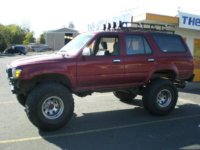

here is a pic. ps. i also have a 1" body lift

i run 33x12.5's with zero rub issues at all with no lift and plenty of room and flex all around for now, your truck looks really nasty, what exactly is all done to it

Just b/j spacers, 1" lift spool in the rear end trutrack in front. 36" super swampers and 529's

Your truck does look great but you must get some rub at lock to lock,
I am surprised that you don't have something similar to what happened to the wheel well on my '81 with 4" of lift..Damage was from the PO, but he said it happened at full left turn when the wheel was stuffed.
Looks like you only have about 2" of clearance with only a slight turn to the left.

those wheels make a big difference. i have 35" stt's on 8 in wheels and they dont rub at all.

What's the backspacing on the rims? How much tbar crank? What did you do in the rear to get rid of the sag and match the front?
Ever take it offroad? Rub when it flexes?
I ran 34x9.50 TSL's (measure the same as a 35 MTR) and they rubbed SIGNIFICANTLY so I'm finding "they don't rub at all" hard to believe.

No rubbing? Did you trim the fenders? If not, I find this curious.
I had 33x12.50's. I had bj spacers, and non relaxed tbars. Wheeling it rubbed all day long. It was retarded.
Please post a picture of the front of your truck down near the ground so we can see the front suspension.

i find this very hard to beleive you have about 2 inches of lift and i have around 3 and i rubbed A LOT with my friends 35s on

I agree; looking at his truck in the pics, looks more like 4-5 inches of lift. No way in hell does a 2" lift enable you to run 36's without trimming all the way to hood.

how would i get 4-5 inches of lift without a bracket lift?

Torsion bars cranked all the way, 3" body lift, shackle lift in rear?

I have 1 1/2 b/j spacers, 1" body lift and l/c coils in the rear. the 36 rub bad because of the wheels. my 35"s dont rub. i will post pics of the 35"s later.

35's aren't rubbing at all????? WOW!
