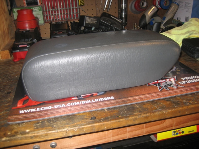

This has got to be one of my better interior junkyard mods....cheap ($7 + double sided tape cost), fast (45 Min), easy (screw driver, pliers, dremel tool), and the long term comfort benefit far outweighs those items.
This works for those who like to rest their right side elbow/arm while driving and have noticed that our center consoles are too short to be of any benefit in that manner.
98' Camry Wagon center console arm rest pad (or something similar).

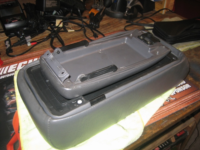

Just going to place the original pad inside the new pad so you can always revert back if you wanted without any permanent damage.

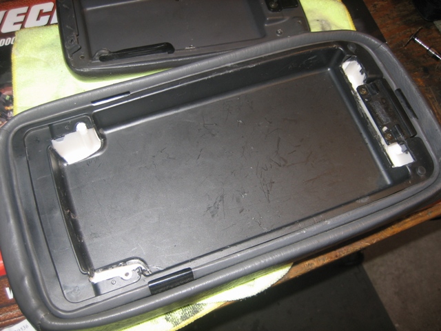

Cut out the plastic so it fits inside and remove the locking tab.

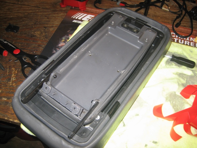

Double sided 3M tape
Place inside

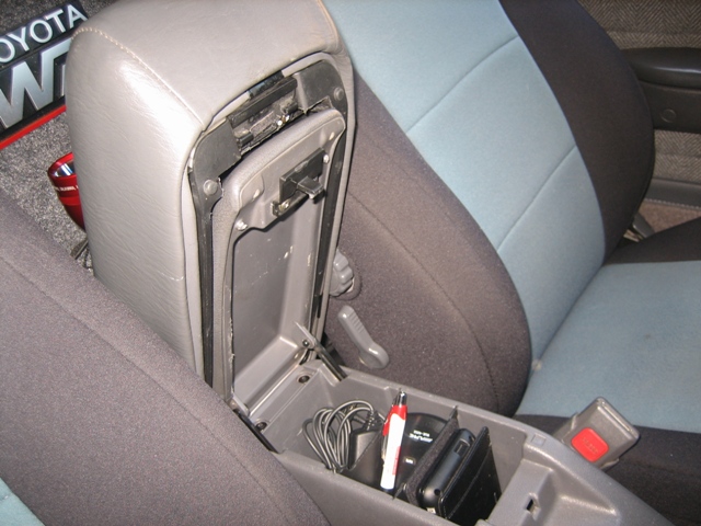

Looks a little unclean/funky from underneath, but nobody sees that anyhow

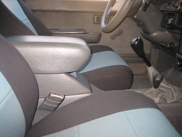

Pure comfort!!! your arm is pretty much at shifter level now.

Thats nice man, way more comfortable driving I would assume, Im one of those right arm resting type guy as well, good find and write up.
