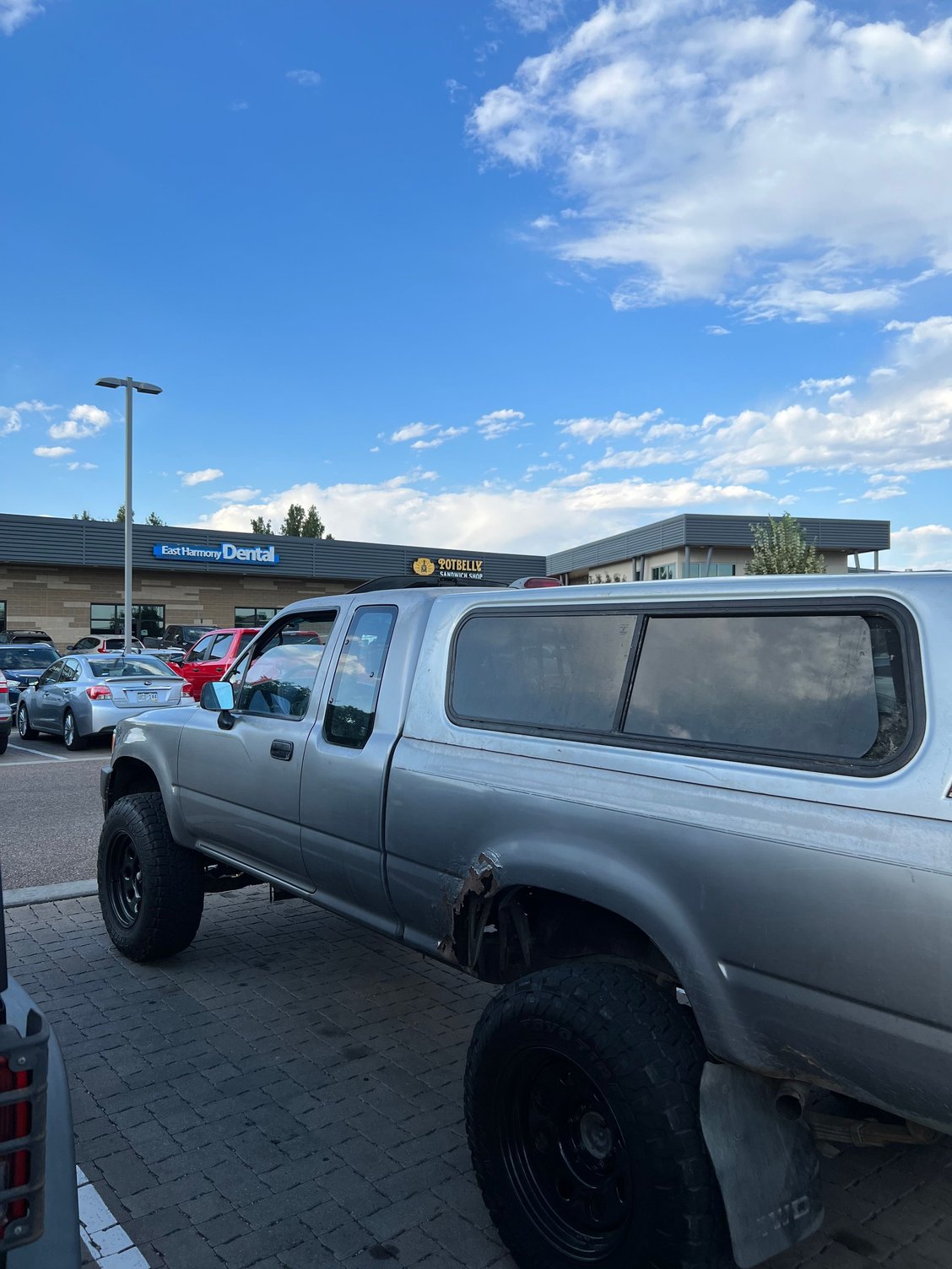

I have a 1994 Toyota DLX Pick-Up Extended Cab and wanted to get bucket seating so I could get a middle console for better storage. I heard Nissan Pathfinder and or X-Terra Seats fit Toyotas bolt pattern but never got clarification. I know 4Runner seats fit but junk yards around me all want $200-$250 PER seat which I'm not really looking to spend $500 on seats that aren't even brand new. Went on here to find a bed panel I couldn't find for months and y'all found 3 links in 1 hour so hopefully you Yoda enthusiasts have some links or knowledge for a bench to bucket seating that doesn't totally violate the wallet. Thanks y'all.
Here's the Yoda if y'all were curious
