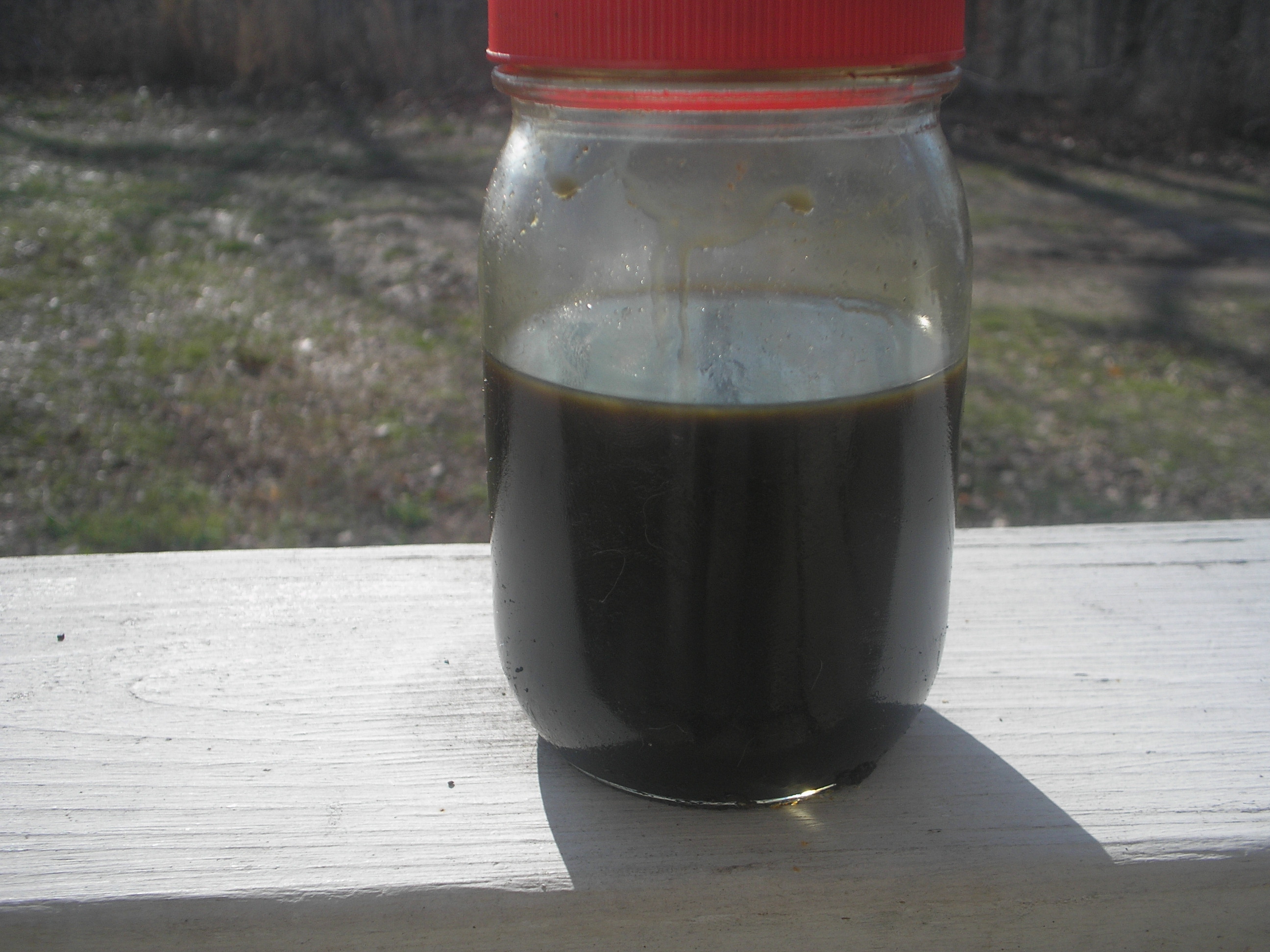

Old Mar 19, 2017 | 05:40 PM
Learning's Avatar
Joined: Mar 2017
Posts: 124
Charchee, atcfixer, JJ'89. Thanks for your comments above. I am grateful for the help to pinpoint the exact problem areas.
First, I did what Charchee suggested by draining oil from the oil pain using a clear glass jar. I enclosed the pictures below. So far, it appears some different color above the black oil or maybe not due to reflectons of the sun or something else. I also put in magnet inside the jar to attract metal particulars. I stirred around inside the jar and no metals or anything else sticks to the magnet. I did this eariler today and will report again tomorrow since Charchee indicated to wait for about 24 hours later.
After that, I will continue to do the next several steps in order:
Remove valve cover, take picture under the valve cover.
Take picture of chain and chain guide cover, if possible. Also, check the timing chain is loose.
In addition, in order to determine whether the engine is bad or not, since there is no crank, I will go ahead try to turn the engine backwards with the crank bolt and a breaker bar or ratchet later in the week. if it moves then something is stopping the engine, hydro locked, stuck lifter, broken rod, etc or a bad starter. With good compression the engine should still start, even with bad bearings, according to the previous post by atcfixer. If the engine does not turn backwards, then the engine is no longer functioning (engine is dead and done with) and need to be replace. (I hope not).
I am repeating myself again in this thread. I am just being thorough and follow through exactly as I stated. I don't want any mixups/confusion on my part. Stay tune.
Attached Thumbnails blown motor?-p1010088.jpg   blown motor?-p1010089.jpg   blown motor?-p1010090.jpg   blown motor?-p1010091.jpg
Old Mar 19, 2017 | 06:25 PM
Charchee's Avatar
Joined: Jul 2012
Posts: 893
From: Arkansas
Still a little early on your oil jar. You set it up outside so if you don't see the water line in the morning, don't move it and set up a light behind it after dark tomorrow or before work in the morning when you aren't getting sunlight from all angles. Looking back in your pictures from before, I can make myself see water in your oil filler hole but pictures can be deceiving. I'm not ready to call it yet. I'd sure take that valve cover off before you try to turn it with a wrench. If you have a helper, you may be able to see something in the valvetrain that has you locked. Would be good to look at both of those things at the same time. Not a big deal thought if you're just turning it backwards a few degrees but you are going to end up there anyway at some point.
Old Mar 19, 2017 | 06:44 PM
Learning's Avatar
Joined: Mar 2017
Posts: 124
Charchee, thanks for your comments. Stay tune for updates.

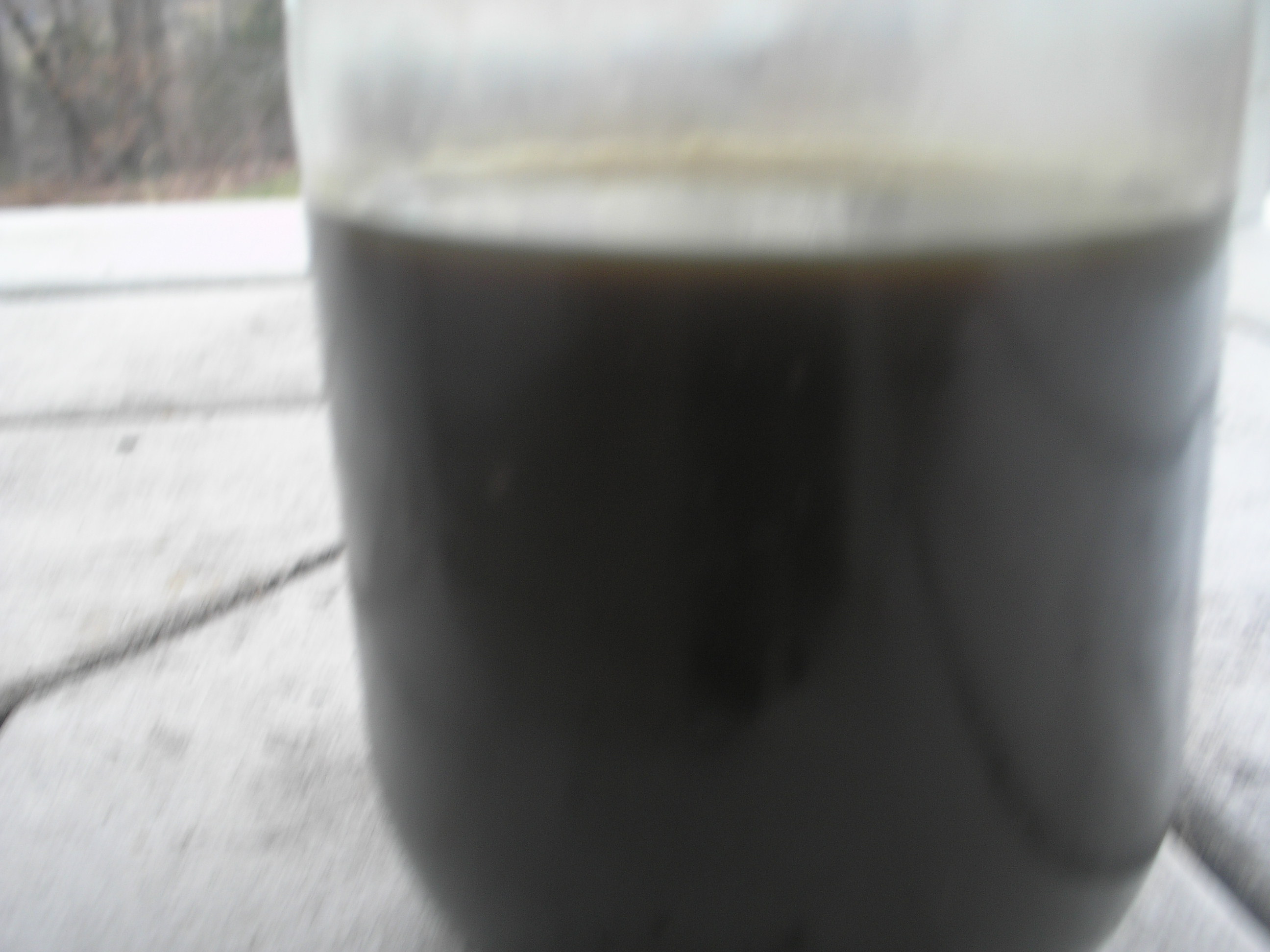

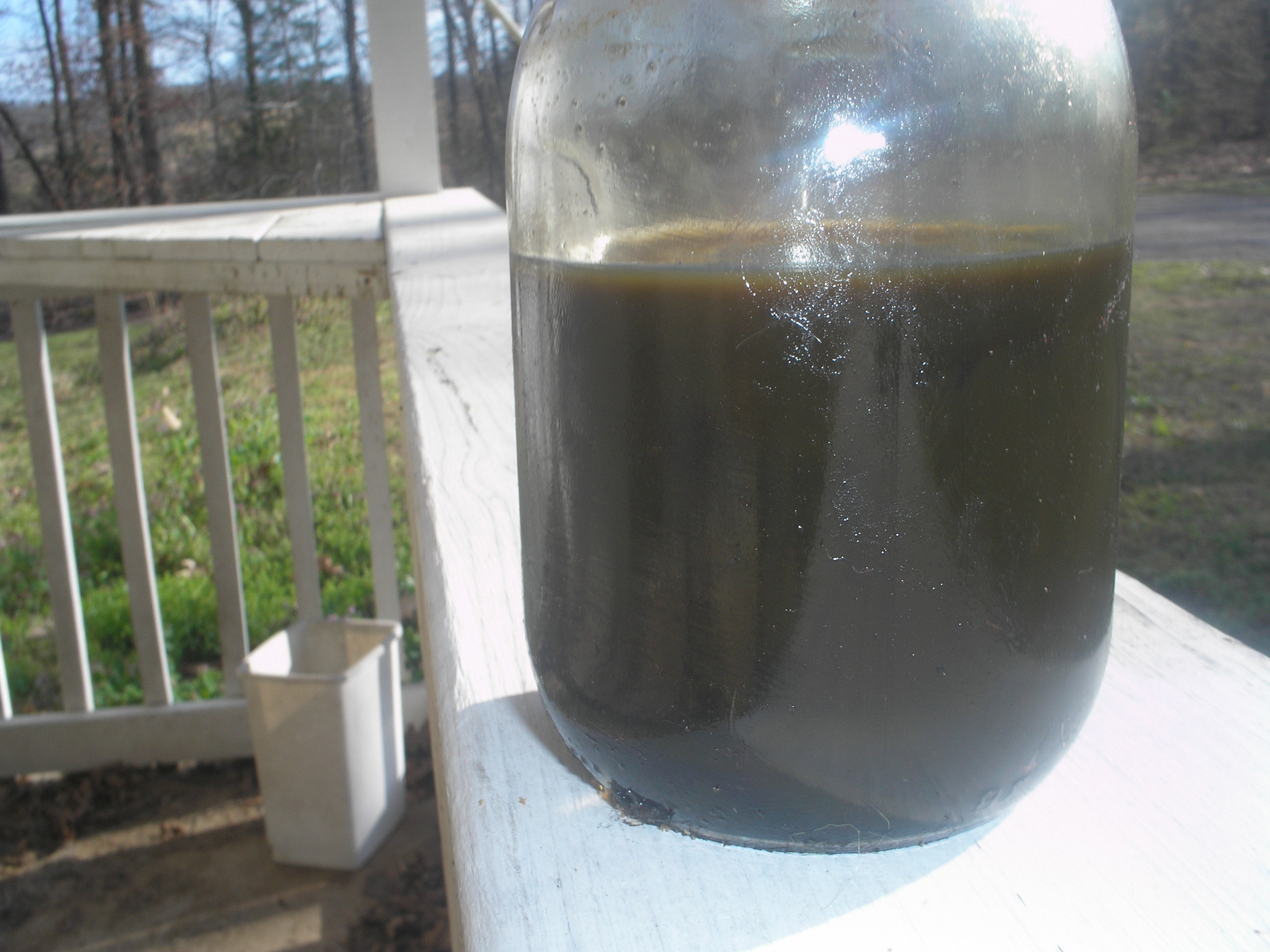

Old Mar 20, 2017 | 02:54 PM
Learning's Avatar
Joined: Mar 2017
Posts: 124
Oil in Jar update
See the pictures of the oil in jar below in attachments. This was taken later today this evening. So far, it looks like the oil is holding up without any water shown, right? That means the engine is ok and not broken. Next step is to turn the crank backwards to see if it moves and not forward. If it moves backwards, that means the crankcase trying to go forward is not turning due to other components such as bad timing guide, worn out starter motor, etc. First, I will remove the valve cover, timing chain parts and other parts to gain access to turning the crank on the engine. Stay tune for updates
Old Mar 20, 2017 | 04:47 PM
atcfixer's Avatar
5 Year Member
Joined: Sep 2016
Posts: 808
Likes: 41
From: Mid Michigan
You should be able to sneak tools down to the crank with out removing much. Worst case pull the skid plate off and do it from under the truck. Timing parts don't need to be pulled to check if it rolls backwards. Also try to go forwards too (carefully). If something stops it from spinning, you don't want to damage whatever it is, if it isn't already damaged atleast. You don't have to use the crank bolt, it's just normally the best option. You could try to spin it by hand, or the alternator too. You might have to press down on the slack side of the alternator belt so it doesn't slip. If it doesn't move, don't go overboard trying since it is possible to damage belt.
The starter mention was purely for the fact the starter solenoid could be bad which would just click like it's trying to work, but not actually spin the motor, it shouldn't interfere with spinning the motor by hand in either direction unless the shaft is stuck out which I've never seen on a yota.
Oil seems fine, that just tells us there isn't water in the oil. If there is something majorly wrong with the engine, it likely is worth fixing it vs replacing the whole engine. The oil does look quite dark, has it been a long time since the last oil change, or do you use cheap oil? It's darker than what mine looks like after 15k miles, unless it's the camera. Pics on the dip stick looks much lighter, so I'm thinking it's the camera.
Old Mar 20, 2017 | 05:14 PM
Charchee's Avatar
Joined: Jul 2012
Posts: 893
From: Arkansas
Hey, in his case, the darker the better. Also, the light source is above it and we're looking through four inches of it. I like the look of it so far.
I can't remember if anyone mentioned this before but, when trying to turn over an engine by hand, taking the spark plugs out reduces the compression and makes it much easier to turn. You probably know that but just thought I'd throw that out there in case you didn't.
