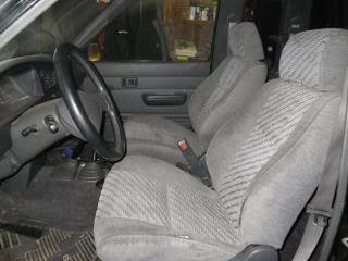

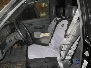

did my new swap tonight,95 4 runner seats,passenger side bolted right up driver side right front has to be modified..Name:  seat_zps1533255f.jpg
Size:  14.0 KBName:  newseat_zps5c8d2073.jpg
