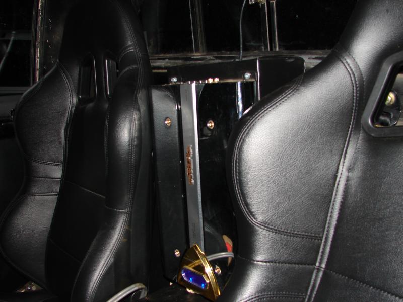

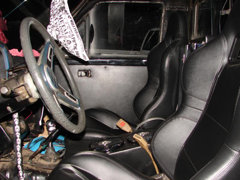

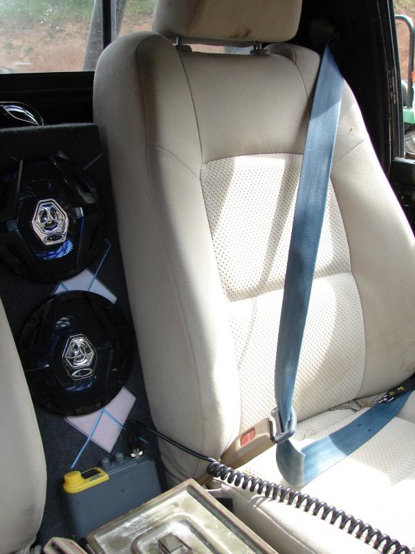

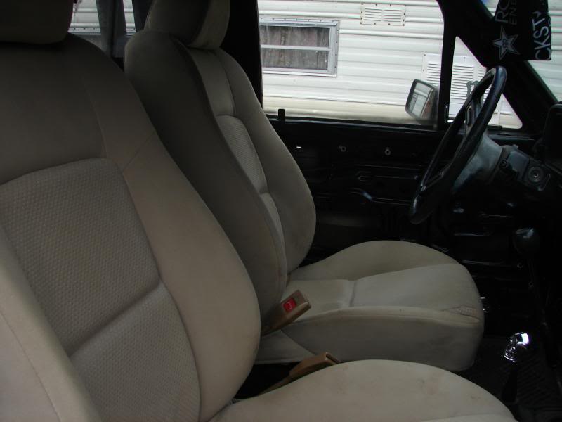

Getting all of that in a single cab will be tricky. i had 2 12"s at one point and it was LOUD! i had some mazda 3 seats and they were a bit tall, but i did get the electrical hooked up to the seats. =)

I later swapped for some cheaper "racing seats" they sit much lower, but i am a short guy. Most will fit in there will a little creativity.
