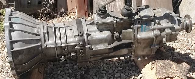

I got an adequate deal yesterday for a 45 minute ride, and my first trip out of Idaho in a few years, a high end hitch carrier for my rig, and an intact and apparently functional tranny/ Tcase combo which fits my 91 truck $75 total.
Currently in the rig is a cable speedo gear and the Tcase at this point doesn't shift as it should, in the free almost deal appears a connector (electronic with speedo sensor assumed), is there still a speedo gear in place so as I could just discard the electronic if so inclined? No mention at all in the Haynes Manual.

91 and older was a cable driven speedometer and 92 and newer is electrical driven. I have always been curious to see what it would take to make one work with the other myself.

I've never checked but would assume that they didn't build a different Tcase for each speedo type so you should be able to remove the sensor and gear as one unit, swap in your other one, bolt up the case, plug in, and drive. Switching from manual to electronic would likely need the computer, wiring, and cluster, from electronic to manual would likely require the cable and cluster.

And it's close enough to the 91 appears the gear is still there they just pasted a sensor pad (like inside the distributor) to the shaft. Only a couple bolts to dig in and take a peek. If so I'm not going to try and repair the current and just swap speedo mechanism and toss it in and call it good.

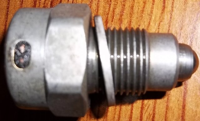

The immediate question I have a switch in the new free one, the one in the rig has a hex plug in it's place. Pictured is the functional simple Normally open switch, leads have been cut off so replacement as opposed to repair. Haynes refers to "restrict pins" If it was further back I would suspect it the missing 4X4 indicator in the dash.

What is this switch for?

Switch might be for reverse lights. Checking switch location against parts diagram would likely tell.

If there was any passage I couldn't imagine what it would be, even submerged I can't imagine a water infiltrate except under pressure. There is another switch with 2 wires which connects to the main harness, I had assumed that was the back up light connection, but that one is on the transfer case so I could have them reversed functionwise, but the speedo also comes off the Tcase so further investigation is required. It's epoxy encapsulated so it is possible to dig thru, rewire and fill back in with JBweld, or a very hot trip to pick a Part

I found thru research that the 4X4 connector is intact, the reverse switch is the one sheared off in the new/free drive set, so the currently installed set with the hex bolt in it's place doesn't have backup lights at all hmmmm?
