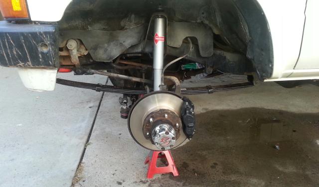

I need to bleed my new brakes.

Old Feb 26, 2015 | 05:33 PM
bswarm's Avatar
Joined: Jan 2015
Posts: 592
^ Nice shocks! I have them also.
Old Feb 27, 2015 | 06:52 AM
fasterspider's Avatar
Joined: May 2014
Posts: 249
From: SFV, Los Angeles
$52.00 for the pair is all they cost me NIB.
