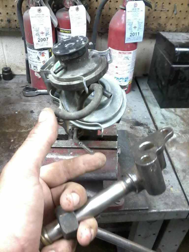

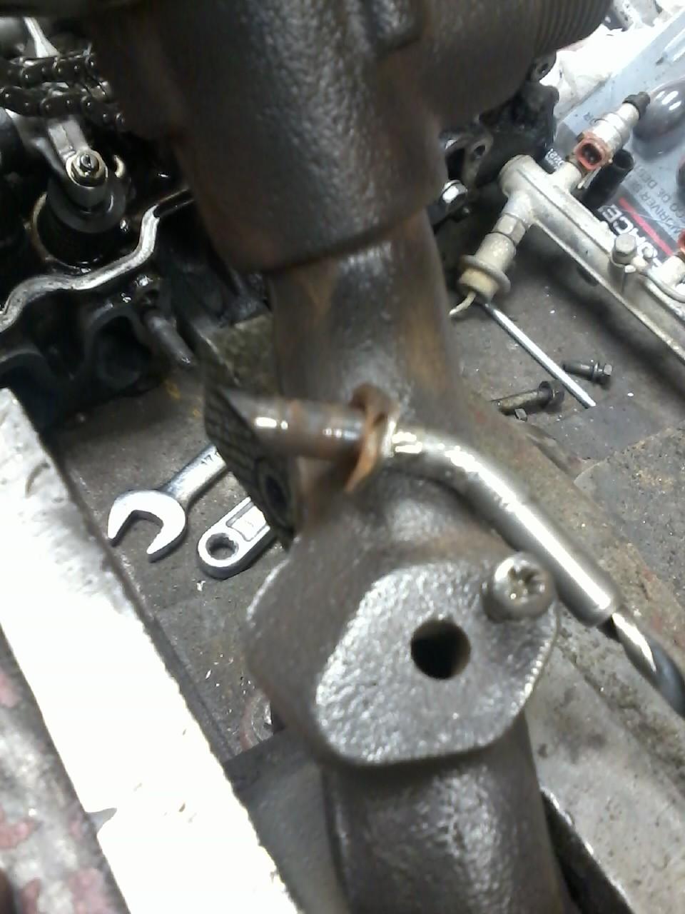

2 bolts hold it to the back of the plenum and 3 to the head. Remove and clean out the little tube on the EGR for the vacuum hose and the pipes attached to the EGR. I will use a drill bit, cloth hanger and air hose. Probably could use brake cleaner or something.
This EGR is set up a little different then most but the Valve and EGR are the same as yours. You should be able to a vacuum on the hose and a vacuum on the EGR and get air to flow through(where my thumb and pointer finger is). I have a drill bit in the small tube. I usually try to take the screw out and but this one doesnt want to come out and dont want to risk breaking. A small wire will get around the bend. Get all pipes clean.

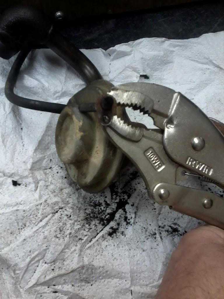

I worked on the EGR. Here is another picture that may look like the wrong way to do this, but the screw will strip if you use a screwdriver. Get a good firm grip, but not so hard to distort the screw.

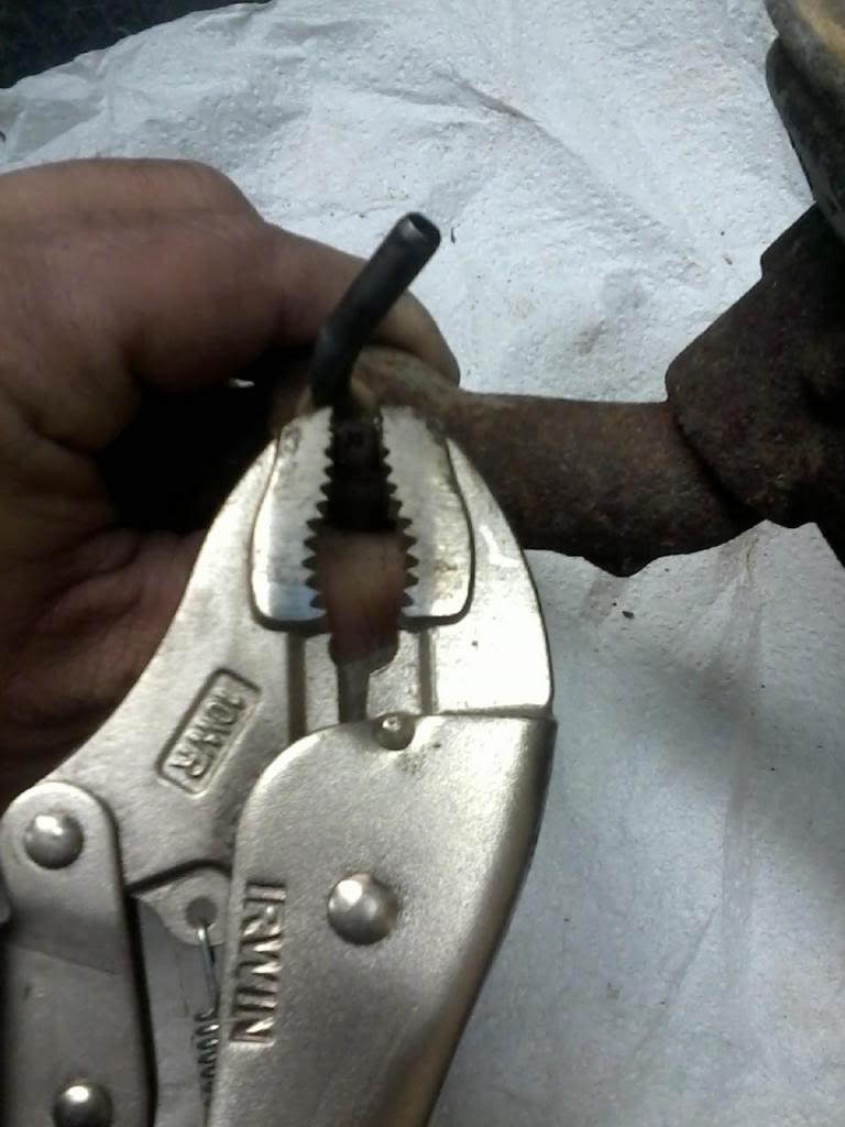

With the screw out, get another bite on the the pipe to get it out of the EGR. Leave the carbon in the pipe at this time as it will help keep the pipe round. The carbon is hard as concrete. Slowly work back and forth to get the pipe spinning inside the EGR tube and to start breaking it free. Could take up to 10 minutes but just be patient.
Here is me using a drill bit. I have never gotten as screw out with a Phillips screwdriver. Ususally rusted to bad. I use vise grips, then getting the pipe out is another job in itself. Take your time, you have to get this out to get all the carbon out.
