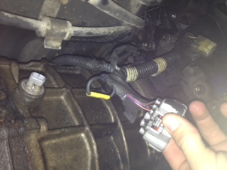

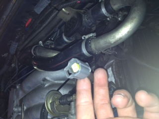

Okay, so Ive been posting awhile now about help with the wiring and stuff for the auto to manual swap in my 1995 4runner V6. I really need some help. Yesterday was the first day i tried to start it after replacing the heads and swapping tranny's. When I go to start it, it cranks but won't start. We tried hitting it with the timing light while cranking and came up that there is no spark. So somewhere from my ECM to ignitor there is a signal to not send any spark.... I have one plug that I don't know where it goes ( At this point I think it might be an extra from the manual swap) but it is from the wiring harness near cylinder 6 in the back almost by the coolant bypass system. (In picture). If anyone knows where it goes that'd be great. Furthermore, I only spliced the two black wires together. (YEs I know I can start it in gear this way. I am completely fine with that fact). ANything to help me get this thing running id appreciate... after 2 months im dying to hear the sound of that engine!

Pic #2
Coolant temperature switch located behind plenum on the sensor block, or knock sensor connector located coming out of intake just in front of #6 cylinder fuel injector, or a fuel injector connector. It is hard to tell from your image, how many pins in the connector? what color wiring on each pin?

I think it is for the coolant sensor.. It is grey cover with 2 pin connectors that are both yellow

What color are the wires coming out of the sensor?

The connector wires goin into the plug are green and a black with orange wire

The engine coolant temperature sensor has a Green w/ Lima (blue) stripe and a Brown with Black Stripe.
Fuel Injectors are Brown w/ Red Stripe and either White w/Red or solid white depending on the side of the engine.
Cold Start Injector Switch has Green solid only.
http://www.ncttora.com/FSM/1990-1995...e/overalle.pdf
