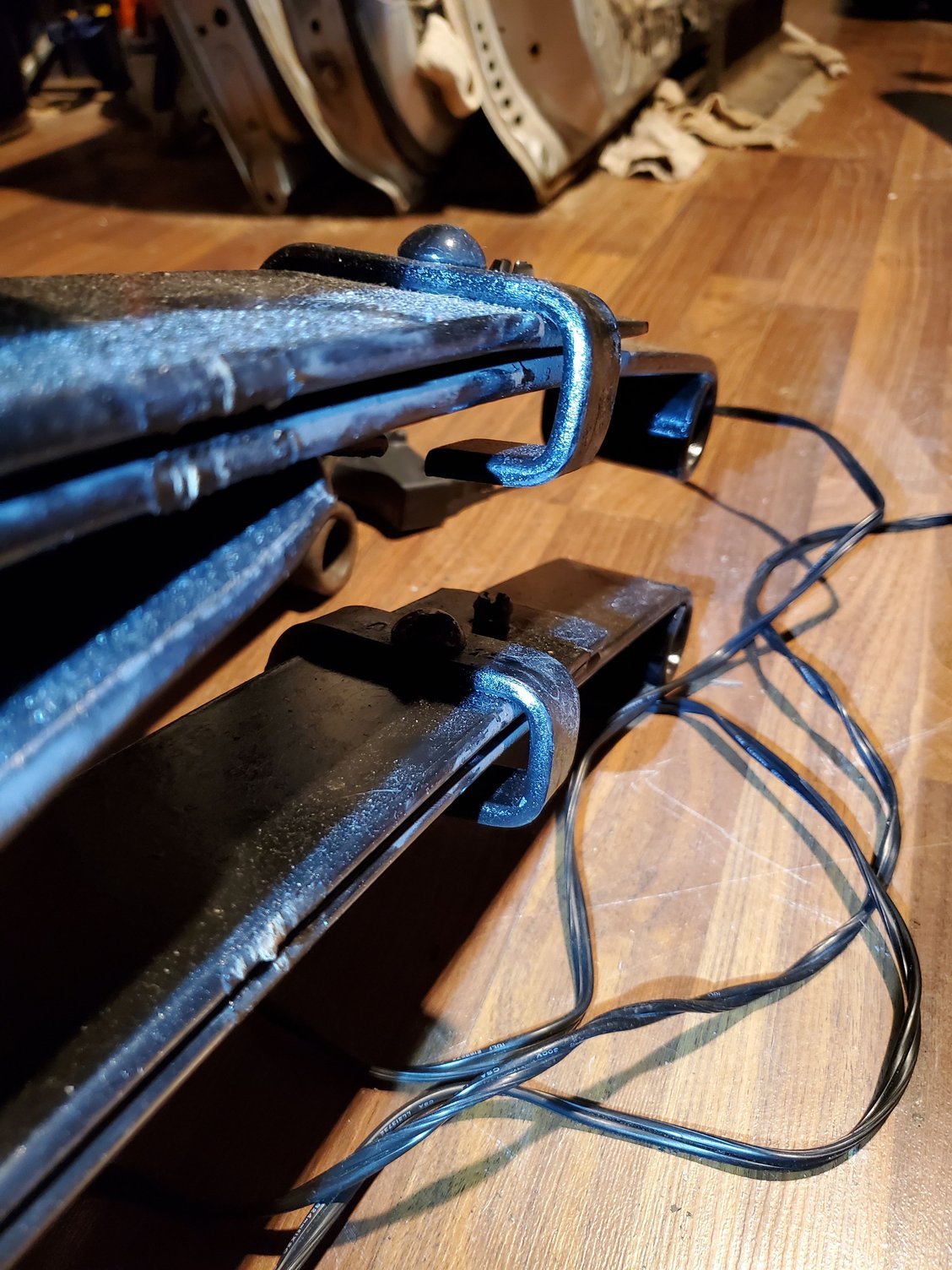

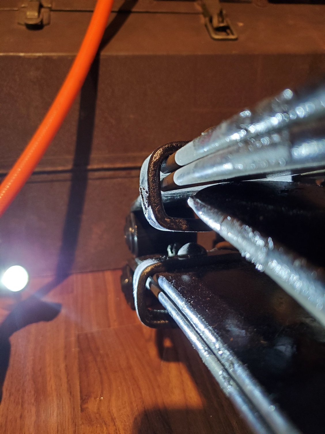

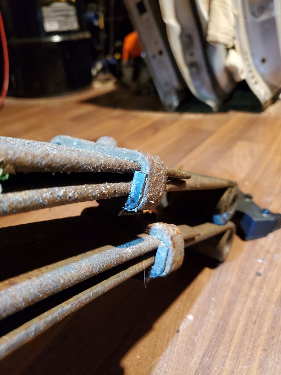

Thanks for the info Max. Boy I sure was in a rage when I typed that Im gonna check out this Carolina Squat you speak of haha sounds interesting. As far as the clips that keep the leaves from shifting side to side on each other, what are your feelings on that? They should be as tightly wrapped as possible correct?
to give you an idea here are some pics....
I would just make sure there is no play on those and check for cracks, if that all checks out it should be good. I would check for cracks near the centerbolt too. That area receives the most stress.

Okay I appreciate the advice. The center bolt area looks fine on old and new. Those clips are what really caught my eye. The new ones in my pictures if you think about it those clips are really doing absolutely nothing at all being that they dont make contact with the sides of bottoms. Essentially I could wrap a piece of bread twist around them in the same fashion and they would be doing just as much as the clips are now. And im not joking when I say that if you really think about it structurally they are doing nothing if they don't make contact with the sides of bottom. I appreciate your input regardless. And if anyone else reads this and sees what I mean please do chime in.

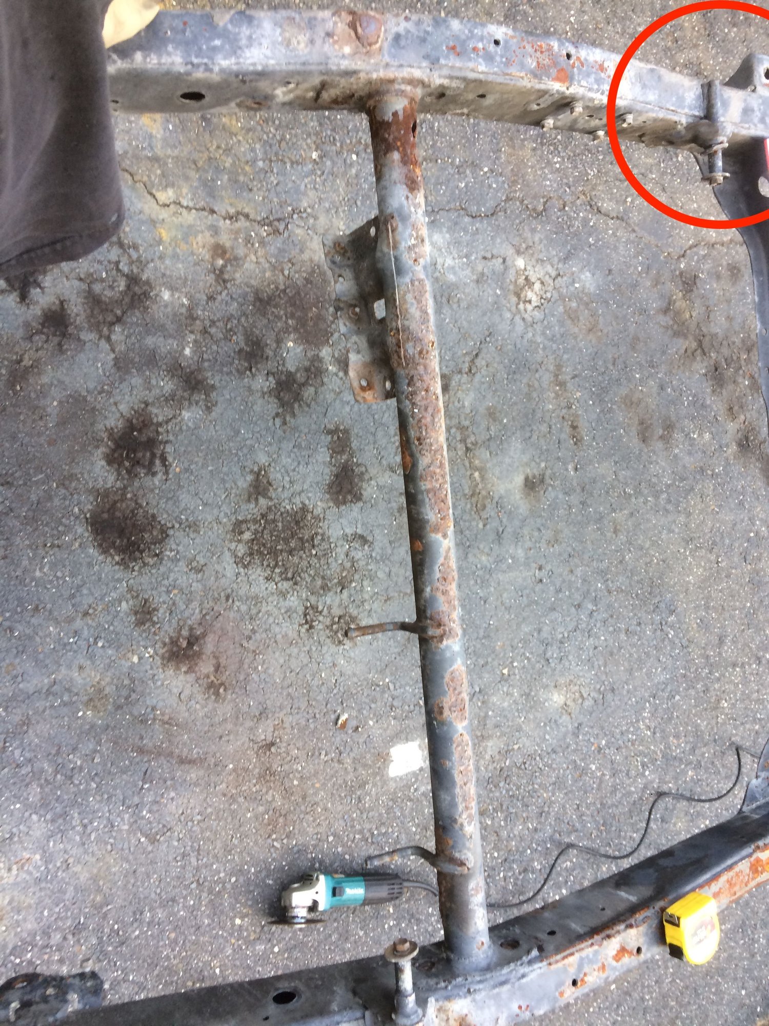

on a side note....I did just notice this
And before taking my truck apart I did always think the back right side of my truck looked a little lower but wasn't sure if it could have been the dip in my driveway or sag in the spring. And I it always crossed my mind to check it on a level surface because that was before I decided to do a restoration. Does that look a little cockeyed to you. I know the orientation of the pic isn't the greatest but that's the back right side.
