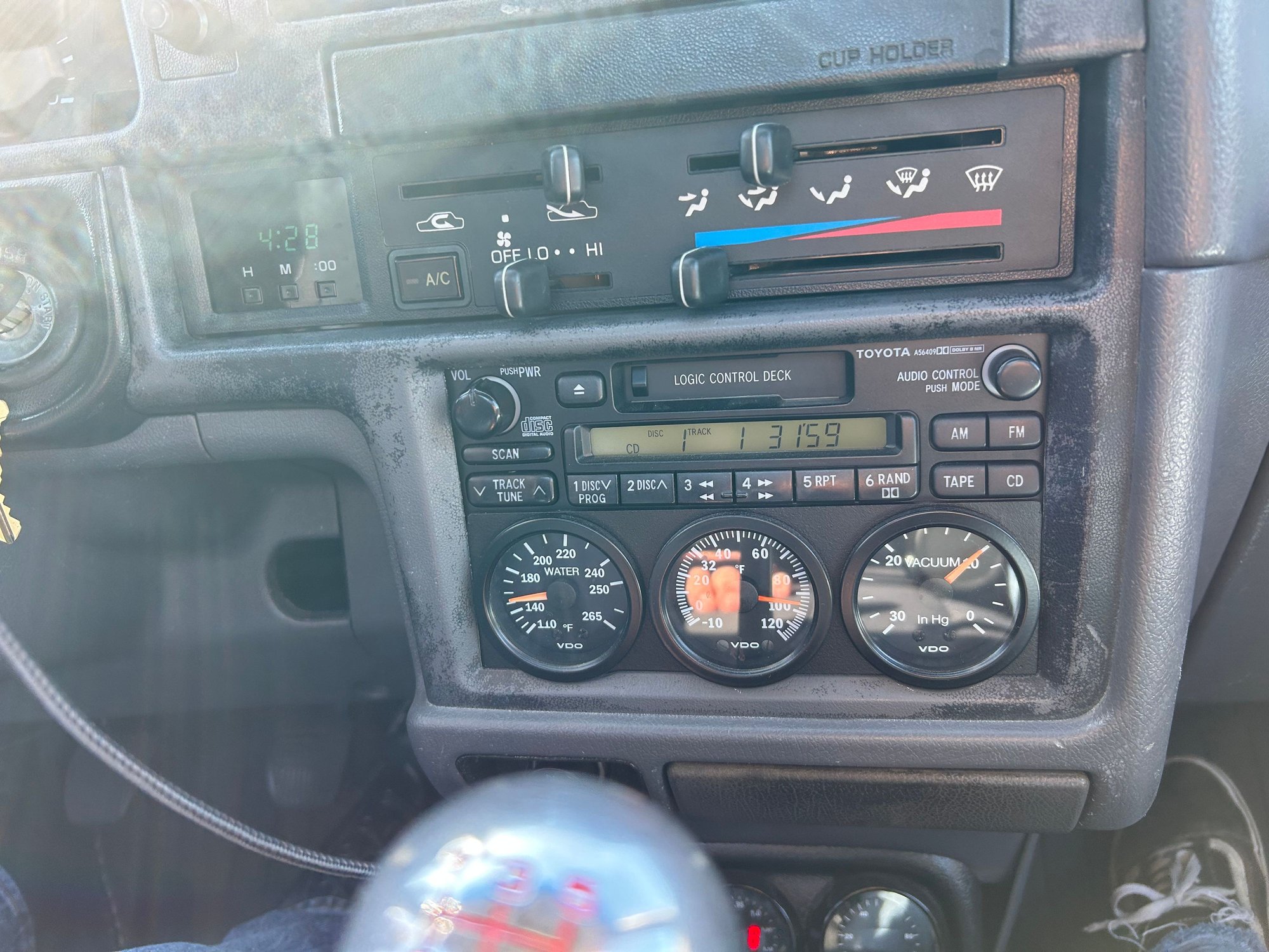

Yeah, the catch can is pretty handy. I removed the original stuff inside and replaced it with some green paint stripper pad as I remember. On mine, I'm running a two stage PCV setup. Under normal cruising it keeps constant crankcase vacuum at about 1/2 in/Hg and then under any load it kicks up to 1 in/Hg. Usually oil in the catch can averages about 1 oz every 375 miles or so +/- when it's mainly just cruising.
I recently did a 300 mile trip in mostly 95-100 degree heat. The water temp exiting the radiator (which is normally around 110F) was hanging out more like 150F degrees. For a while, I turned on the heater inside the cab with the fan on high and the windows down; it only managed to drop the exit water temp down about 10 degrees.

Haha.. yeah, I was hoping for more also. I ran the heater full blast for 10 or so miles and then just couldn't take being blasted with hot air any longer and shut it back off. The temp rose from ~140 back up to 150 or so.
When the temps are 65-70 outside, then cruising along the exit water temp barely registers on the VDO gauge (so that is around 110F or so). But when it goes up to 90+ degrees, that causes the exit temp to climb to more like 140-150 ranges (and this is sailing along on flat ground). I don't remember what the oil temp was, but it wasn't anything excessive. Usually the oil hangs out around 180 or so.

Not entirely sure what the temperature going into the radiator is in that situation. I would think it's probably up there in that range. On my setup, I have the factory (dash gauge) temp sender. It didn't climb at all (it was just in the middle like always). The water temp existing the radiator and flowing back into the motor has the VDO mechanical gauge with a capillary style sender. If it's 50 to 60 degrees F outside (and I'm on flat ground cruising), the temp usually doesn't (or barely) registered on the needle. If I climb the hill going up to my house (about 1000 feet above sea level), then it will start to climb. I think the 150F degree exit temp was more an indication of how little effectiveness the radiator was seeing due to outside air temps being nearly 100 degrees F.
