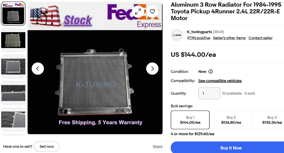

No problem! Glad to help as I've been a long-time subscriber to your Youtube channel, and I've commented a lot on there and always enjoyed the discourse, so I'll take any chance I can get to help out.
Here's the link:
www.ebay.com/itm/324579694082
And just for future readers of this thread who will inevitably encounter dead links once this thread's a few years old, here's a screenshot of the listing:
Interestingly, my ebay purchase history shows I ordered mine from a seller named at_autoparts,
yet when I click "Buy Again" (since the listing itself is no longer clickable), it pops up with that screenshot'd listing from K_tuningparts.
Looks like the same exact radiator images.

Thank you very much for the link and also the kind words on the channel there. I try to answer every single comment/question people ask on the channel and really enjoy chatting over there about 22RE stuff and Toyota stuff in general.
On the bikes... yah, I miss my R1 a lot these days. I've been thinking about maybe building a custom frame super moto or something and throwing in a 2-stroke but so many projects so little time. Right now getting geared up to build this 3RZ-FE turbo in a few years for my truck and for a series on my channel. Actually just heading out the door to pickup some bore gauges so I can measure this block over here and decide if it's a boat anchor or if it's worth prepping further. The block came out of a 1998 Tacoma and looks pretty good, but there is definitely some sort of wear on the cylinder walls (mid way down, gulp). I was hoping I could just hone it and run JE pistons, but I'm thinking it might need a re-bore +.010" but not sure just yet. Dart sleeves? 30 PSI boost? I don't know....
Also trying not to snap anything in my beloved W58 gearbox
Thanks again on the eBay link. That definitely helps out over here.
