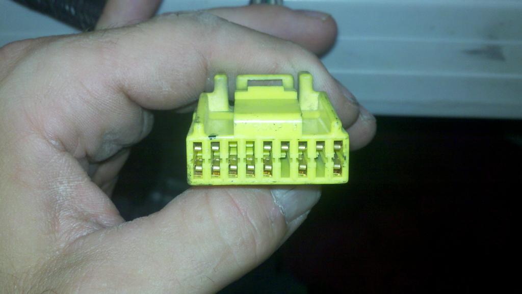

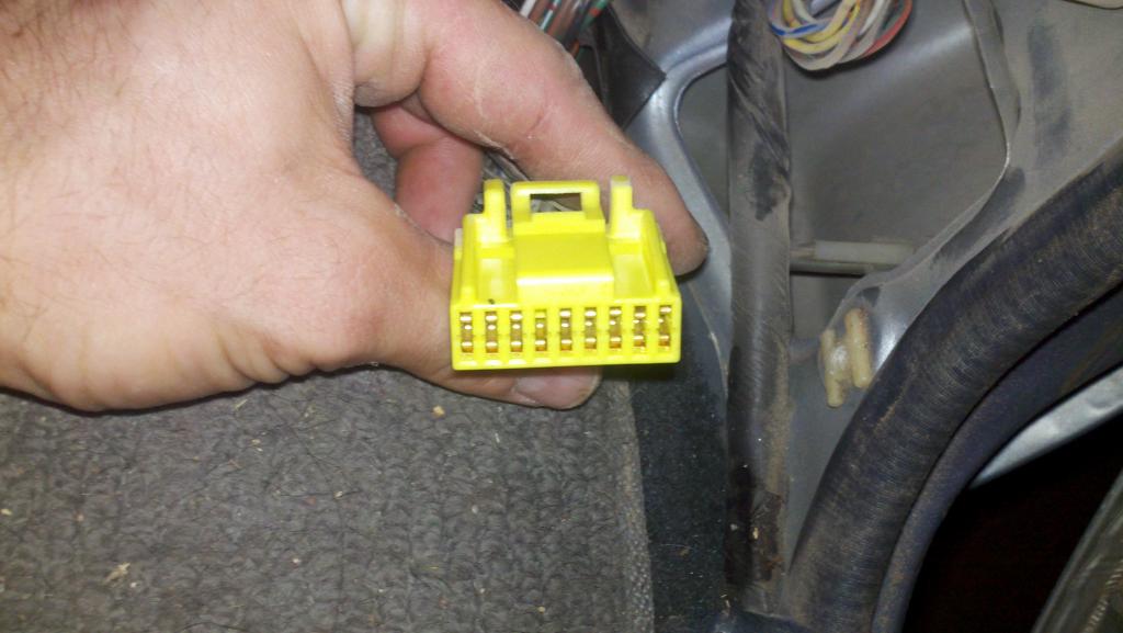

Here is a pic of the 18 pin connector on the 88 pickup thats throwing the code.
Here is a pic of the 86 4runner donor harness that i have
But the Knock sensor plug for the donor harness is pretty beat down
I guess im not sure if i should change the whole harness or just the knock sensor wire itself?? as u might notice the 86 4runner ecu plug does not have as many pins as the 88 pick up ecu 18 pin plug.

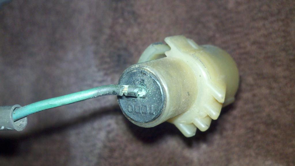

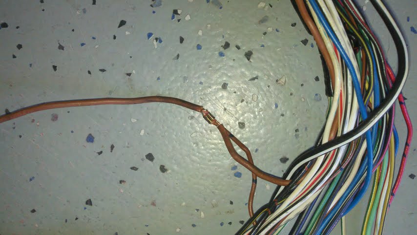

so regarding the knock sensor wire this is what i was referring too, when i removed the knock sensor wire from the 86 harness this is what it looked like
This is the Jumper wire already installed in the truck but as you can tell the steel braided insulation is sticking out away from the wire itself.
The steel braided end was connected right here with the brown wires u can see the crimp were they were all together at one point
Now my ? is when using this jumper wire method do you need to connect the steel braided insulation or what ever that is to the same area? or is that not needed?
