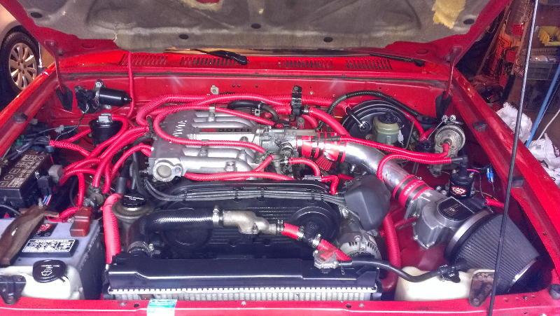

I keep the filter clean it has s cold air intake on it.
Attached Thumbnails Am I having cold start injector problems?-forumrunner_20140825_215352.png
