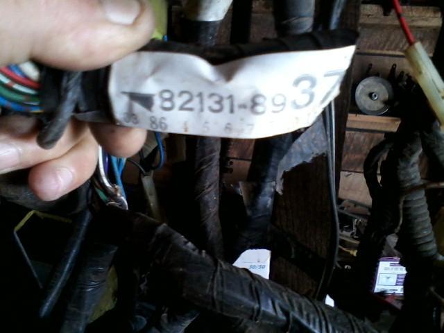

Here is the harness that come out of the turbo truck. Last number was cut off when the PO cut the harness out 82131-8937x

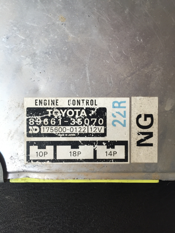

22rte to 22re / injectors not firing-image-3598696390.jpg

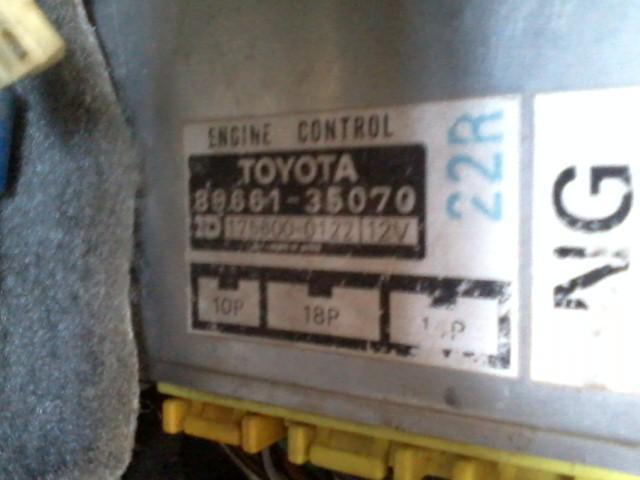

Here's my ECU

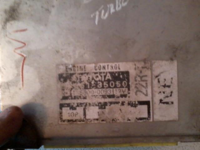

That looks to be the same exact ECU I have in my base model 86 Runner. The part number is 89661-35070.
