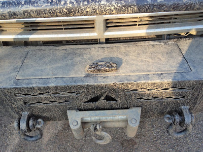

One of the things I like about the Aluminess bumper is that the winch area is fully enclosed and lockable. Or you can leave it unlocked.
The fairlead hole even comes with a powder-coated cover plate in case I'd like to convert it to just storage some day.
The vents do a great job getting air into the winch so things don't rust, plus the 4Runner needs them since the bumper and AC condenser do hang down lower than the grille. A lot lower.
It's easy to remove the rubber cover and unlock the winch cover. There's a trick to locking it - don't push down on the button (silver circle) otherwise you just unlock it and have to scratch your head a while wondering why it's not closing.

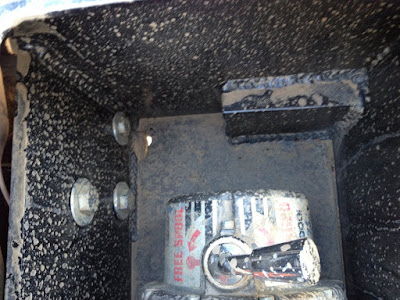

Inside the winch compartment is a lot more beef. Each side has 3 bolts holding the bumper on, and check out that clevis mount. The clevis has a straight pull to the mounting. Less twist on the frame or mounts. Check out those welds. I wish I could weld aluminum that pretty!
Three beefy bolts on each side bolt into the front of the frame. My truck has a tow bar which reuses the tow hook frame holes, they're still on there. Will my towbar still work? I doubt it!

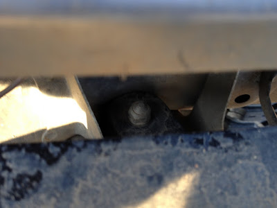

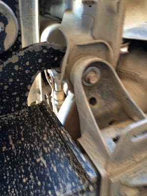

This is the top mount I'd mentioned earlier, where the SmittyBilt mounted. This is shot between the bumper and the grille. Note that the SmittyBilt didn't have any other top mounts, hence the wiggling. I thought it was a nice touch for the Aluminess guys to tie it back into here, on top of the 3 bolts above.
Here's an underside shot of the same mount.
