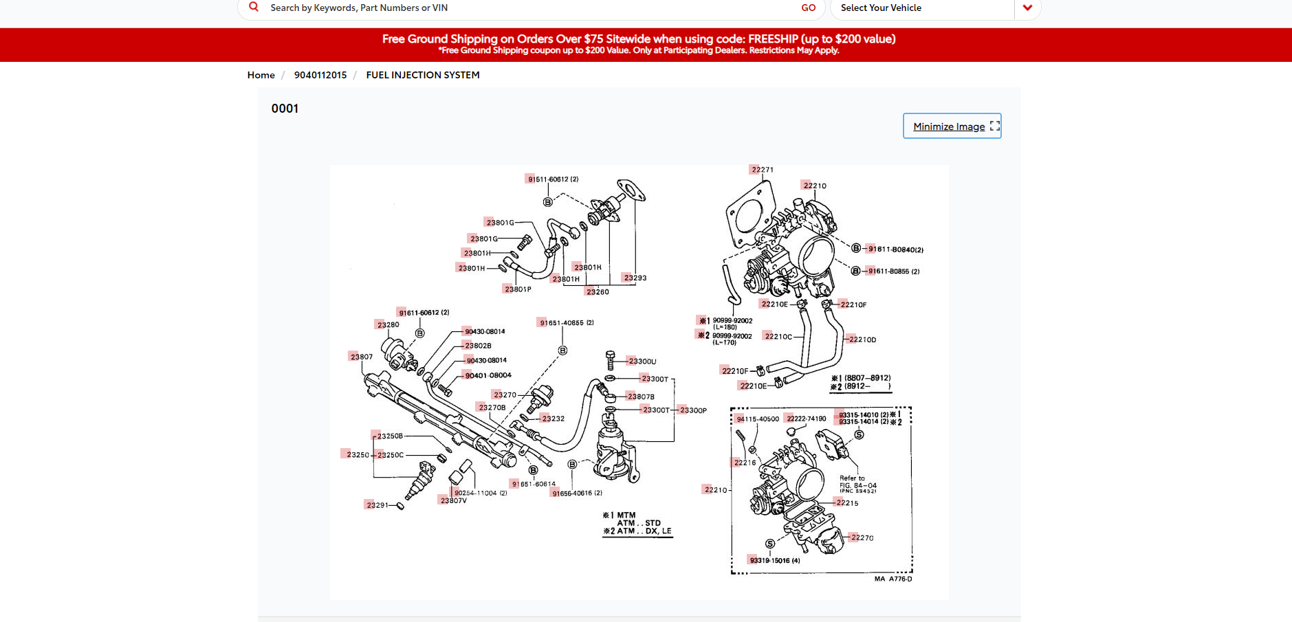

I'm waiting on an order which includes some copper crush washers to connect the fuel line from the passenger side rail to the manifold on my 3vze. Part number is 90430-08005. It's the last damn thing I need to start her up and I'm sitting here waiting for the mail. I would use the old ones, but I did a classic and dropped one of them down the engine bay when I was doing the re-assembly.
Anyone have luck sourcing these elsewhere that I might be able to pick up in person? I expect auto-shops or hardware stores might have some generics.
