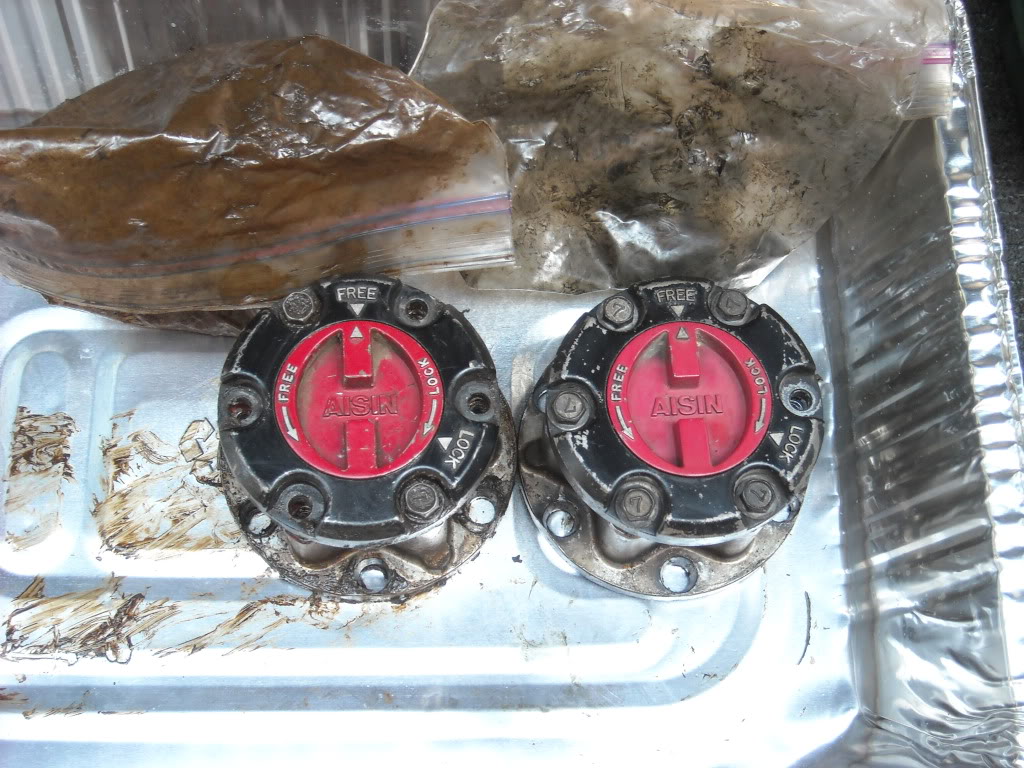

Great write up! I'm doing mine, .... but they'll go on AUTO LOCKING HUBS, not ADD.... So I'ma have to cross this with another good thread to make sure I cover all the steps....
BUT SERIOUSLY.... As I took mine apart, they had been flipped(the spring and pawl were turned over and actually inside the clutch area.... As I took it apart, ..... I realized how freakin filthy they were(full of hay, etc., lol)... So I cleaned em up fairly well... Gonna use this as a guide of what to do/what not to do(via the tips therein of people learning the hard way) and posting this link on my build, FO SHO!
Thanks for doing that(eons ago, lol)...and for continuing to check in(and for making it a THREAD, not a write up with comments disabled )
Best wishes to ya, Space Poppi!
PS> Mine, inside, were REALLY OVERGREASED, ... .not only that, they had a compromised start gasket on one side and the bearing missing.. SO I used ROT's trick and VOILA! Missing bearing ball replaced! (Credit to rustEd, he told me that ROT had done this).... I'm going to soak the clutch/pawl and larger spring(they have the most rust, only rust really) in some parts cleaner for a while... Then Come back to slap em together in a few days when I have the CV's rebooted, one rotor replaced with lifetime warranty and so on....(IOW, when I'm ready to go)...and then I'll use this, FOR SURE, to help get em ready for assembly/install. (I WILL NOT use too much grease, ... read every post.)
My before and afters don't show how bad they were inside... FULL OF hay, RTV chunks, etc. But they seem to roll fine/smoothly... Just curious if you think I need to pull the whole hub apart...(Left the spline/roller section in)>> they seem to be clean.....but I think in using so much parts cleaner to flush em I've left the lower most stuff's dryer than they should be? >>>>

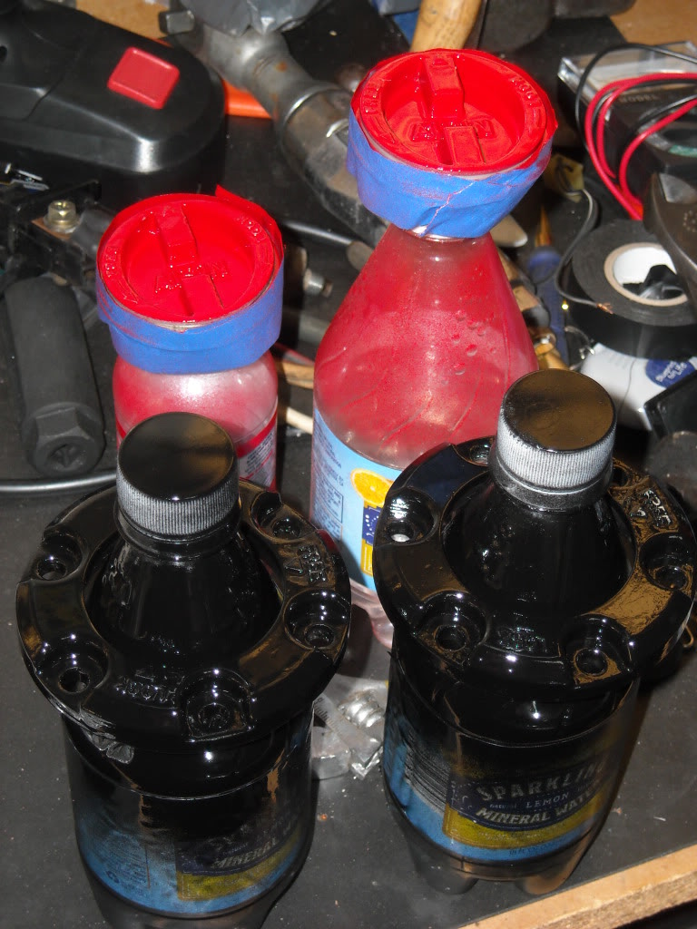

Chef, thats a GREAT idea using the bottles as a paint stand! i made the mistake of using the foam crap that is used to pack large objects like TVs... yea, just an FYI, that crap melts and smells bad... LMAO! lessons learned when i was "young" hehehe...
thanks for the comments guys! i appreciate it...
hard to believe that this was the FIRST mod that i ever did to my first toyota... seems so long ago... haha... and i STILL need to do this to my Tacoma... thinking of going black for the ring and white for the dial face... since i have white wheels and whatnot...
