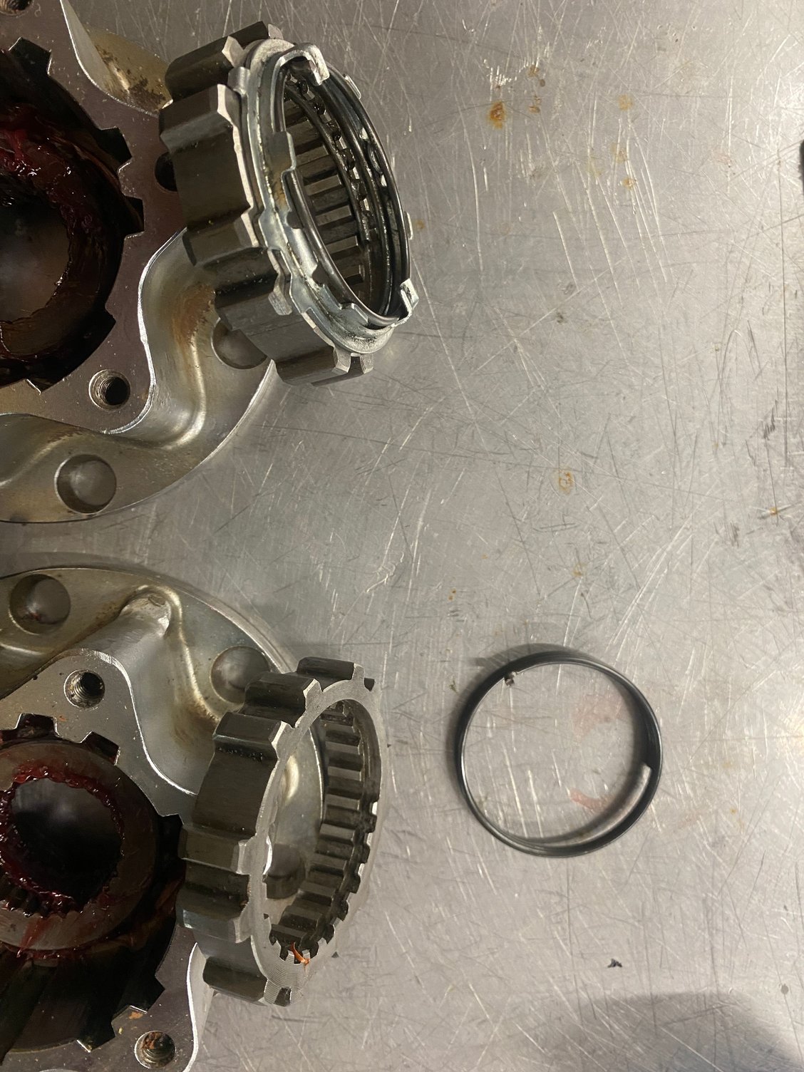

I've searched and searched but now I gotta ask...I know the end of the spring that goes between the hub clutch and pawl is supposed to be aligned with the last tooth on the clutch, but my 2 clutches aren't the same...and maybe that's normal. What I mean is the 'last tooth' in the hub clutch comes from the right on one, and from the left on the other. However both springs are both coiled in the same direction. So are there supposed to be 2 different springs? Thanks for any guidance for this noob

If you needed to replace both hubs you’d order the same part number x 2. There isn’t a driver/ passenger side hub. So, in theory, both hubs should assemble the same way..

Yeah thanks I figured it out, I don't know what the hell I was thinking that day!!
