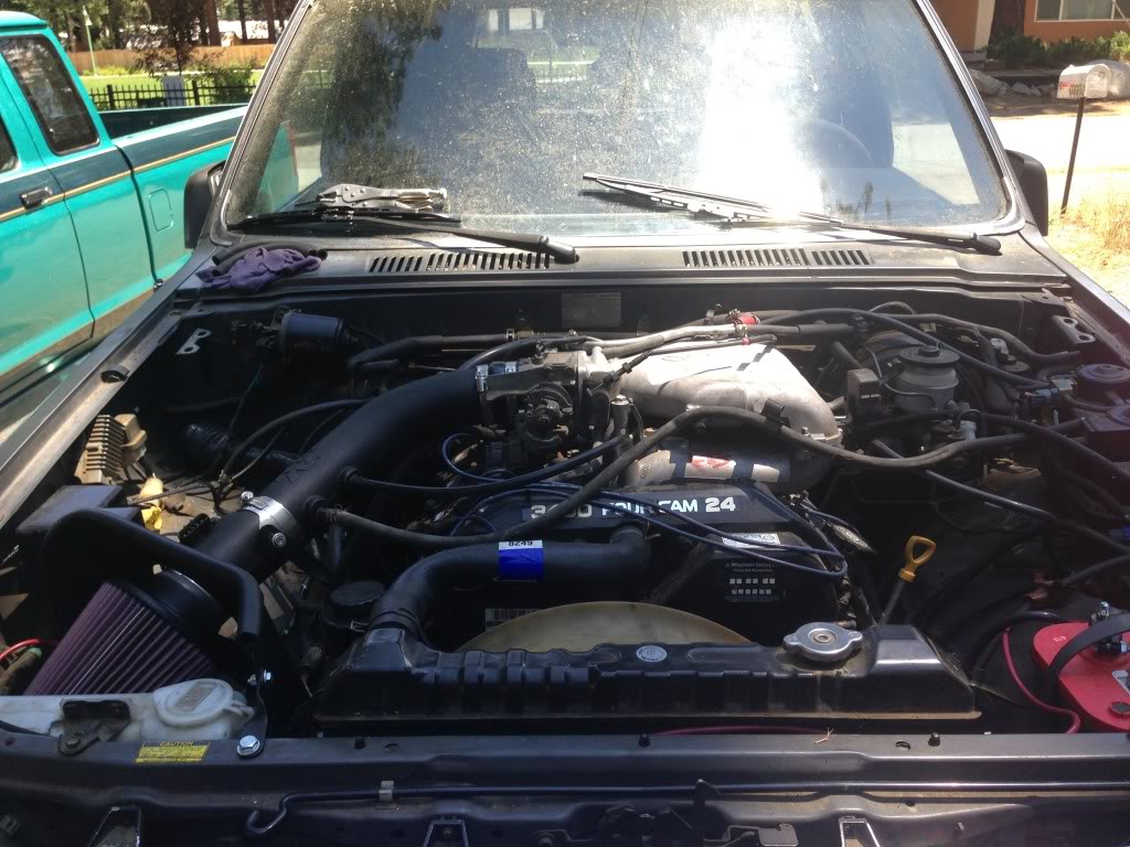

Oh fer cryin' out loud -- just fix it! An entire rebuilt PS pump is $60 http://www.autozone.com/autozone/par...mString=search, and at least when I got one 8 years ago it came with the correct idle-up valve.
Yes, you can put a "patch" on it by blocking off the valve, but you'll also need to raise the idle to keep the truck from dying every time you parallel park. Up to you.
Moto260: did you just leave the vacuum lines hanging? I wouldn't expect it to start or run if partially assembled. But if you're experienced enough to shoe-horn in a 3.4, I would guess you already know that.

No mechanic but yes I got the 3.4 put in my 88 runner. All the lines are hooked up but this one. Name:  E609A913-9E38-4398-A735-FB91E8661DCB-293-0000001462840B29_zpsf499be7c.jpg
Size:  152.0 KB. It was capped before I tried to start her up. Then she wouldn't crank so I pulled it off and posted it on my thread. They said its my idle-up air control valve to my p/s pump. I got the pump but no where to connect that one, along with a plug. I think the salvage yard just screwed me out of that piece. Everything else looks good Name:  9E931640-3F7F-4F57-A7C5-AB578F35B857-159-00000007ABB32FA9_zps25231883.jpg
