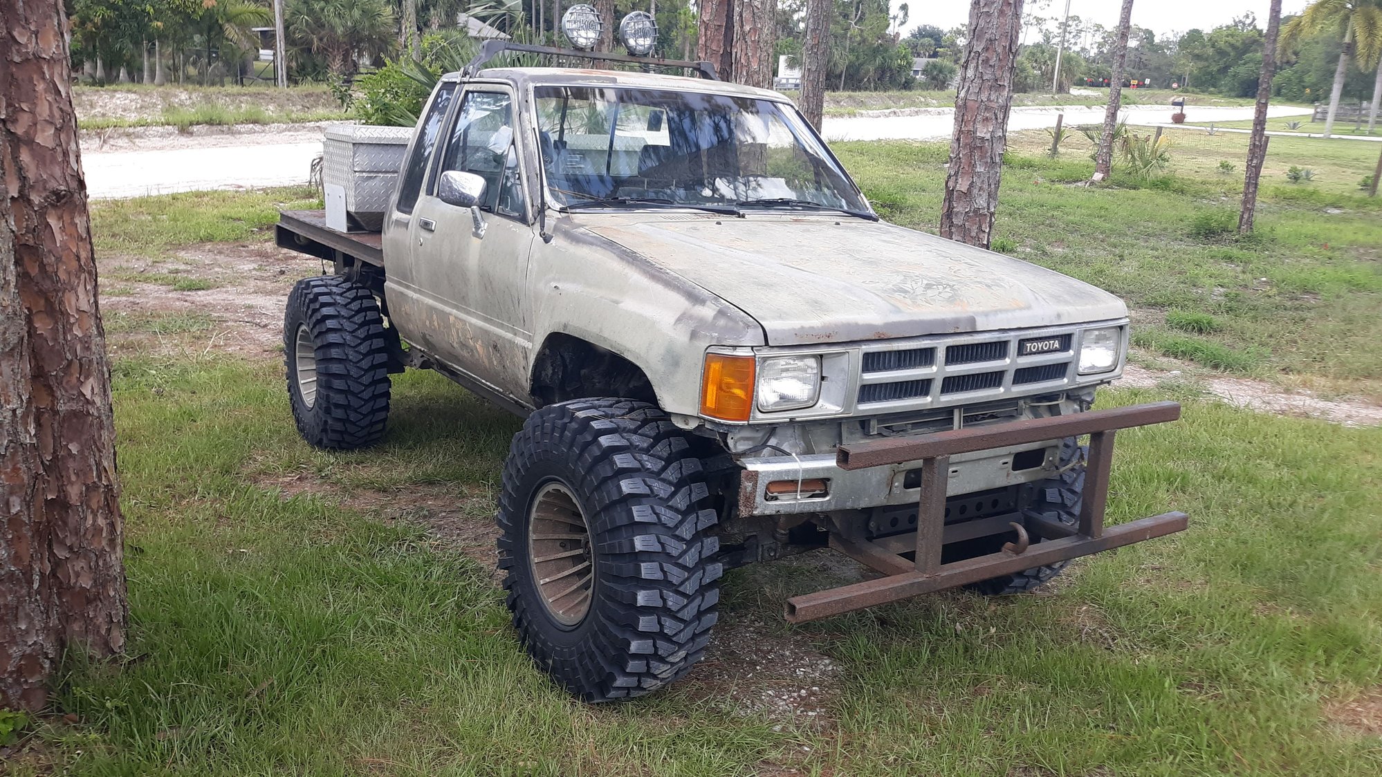

So I recently picked up an 86 extended cab pickup 4wd for 2k a few months ago. The guy I got it from used it as a hunting buggy so you can imagine not much maintenance was done.
I got it with 68k miles, clean title and beautifully running 22re with the automatic (although I wish it was manual).
After a few months of fixing up things that werent taken care of or were broken (hub rebuild, new brake drums and hardware, axle seals, wheel bearings, calipers, rotors and brake lines, lspv bypass, and some interior cleaning, fluid flushes and change) its about time to start upgrading.
So the plan is to build a rock crawler down the road (this is a trailer rig only)
5.29 gears (shes on 35 treps)
Rear spool
Propane conversion
Home made snorkel (florida living)
Chevy 63 spring swap for the rear
Bj spacers for the front (plan on chopping the front ifs for a sas eventually so I dont want to spend too much on the front)
/\ mounted rear shocks (thinking 12inch kings or jri)
Roll cage
Transmission and gear box swap so u can run dual cases
Eventually a front selectable locker
And the list goes on.

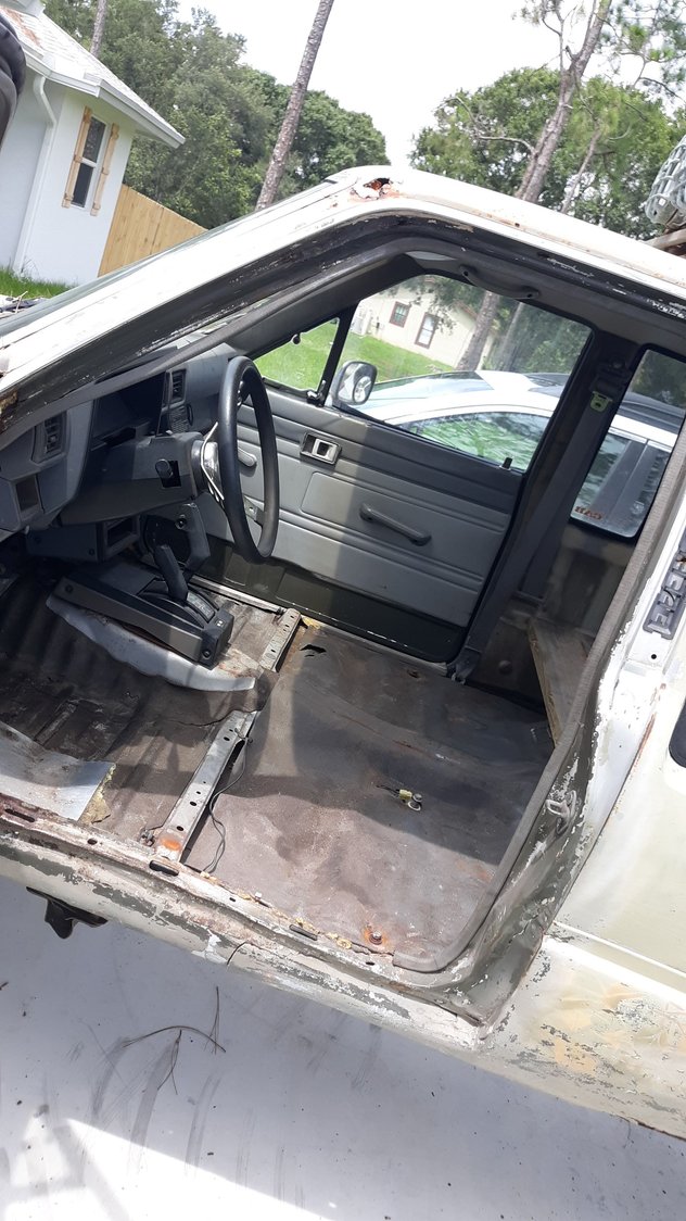

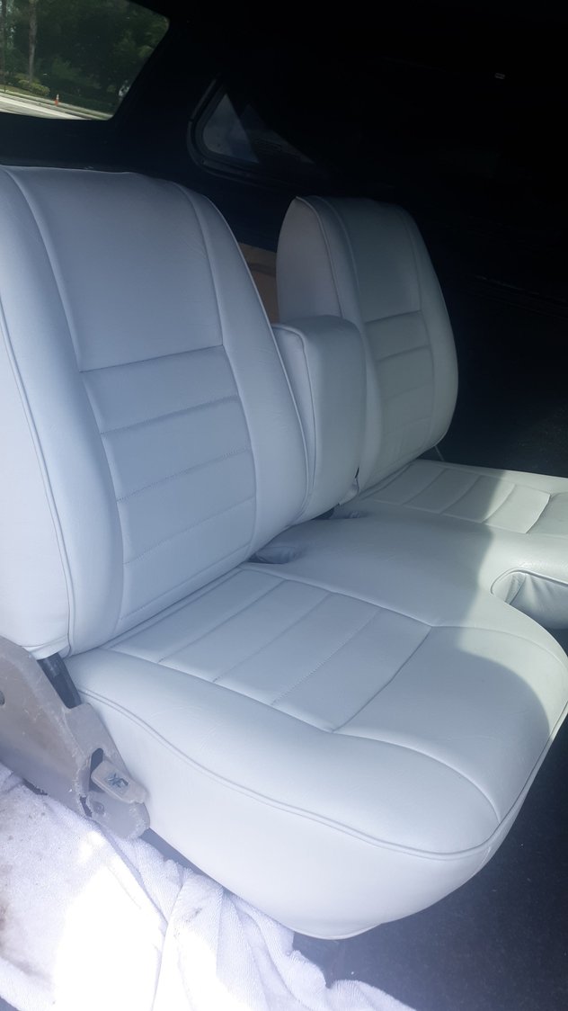

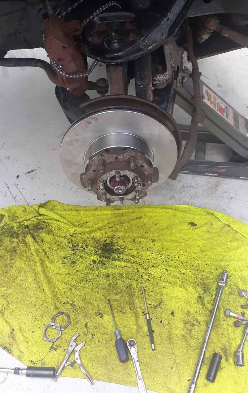

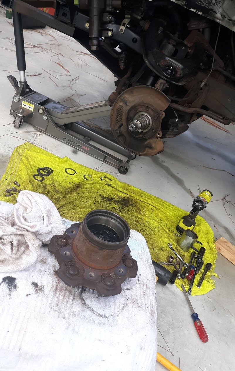

Couple photos from the truck
Getting new bearings and some love
New rotors calipers lines etc
Gutted the interior to fix rusted floor pans
New seat reupholstery marine waterproof material

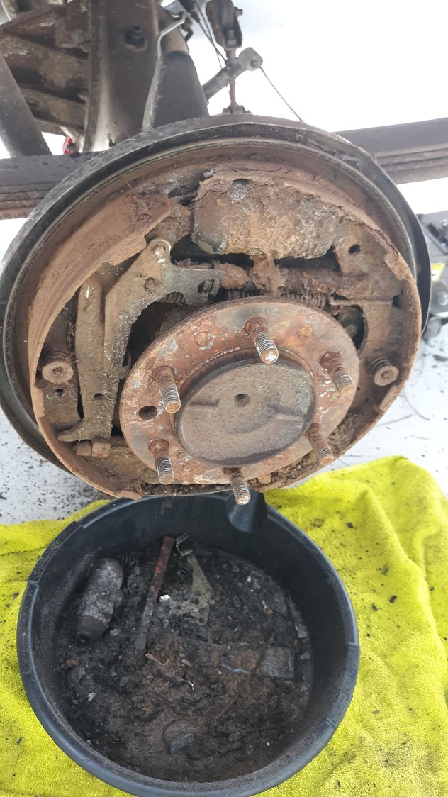

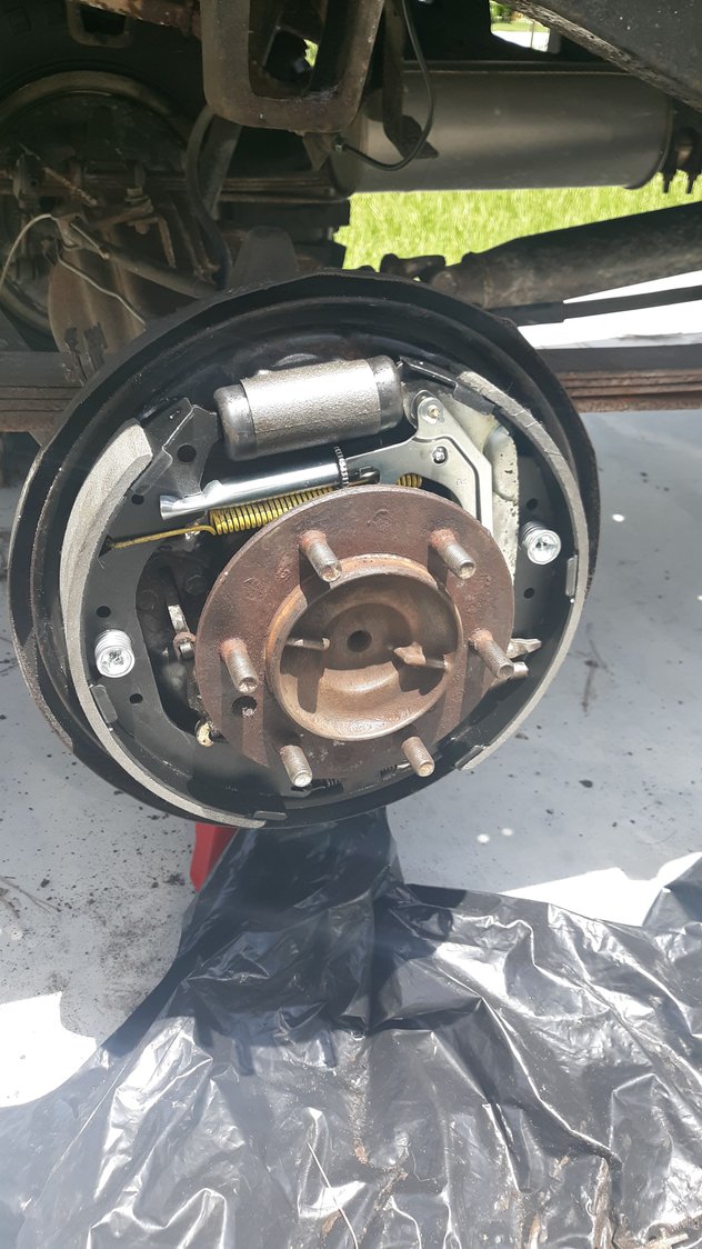

Old Aug 22, 2019 | 09:54 AM
Warwagon's Avatar
Joined: May 2019
Posts: 107
Likes: 36
From: Florida

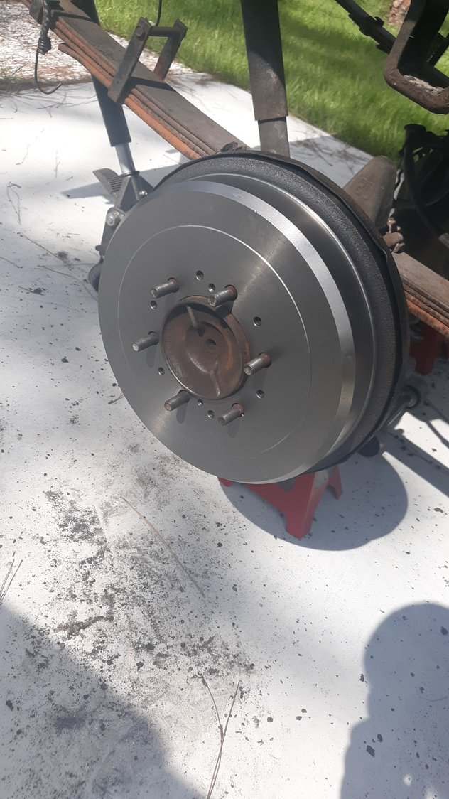

Before
After, and yes i adjusted the star wheel mechanism properly
After

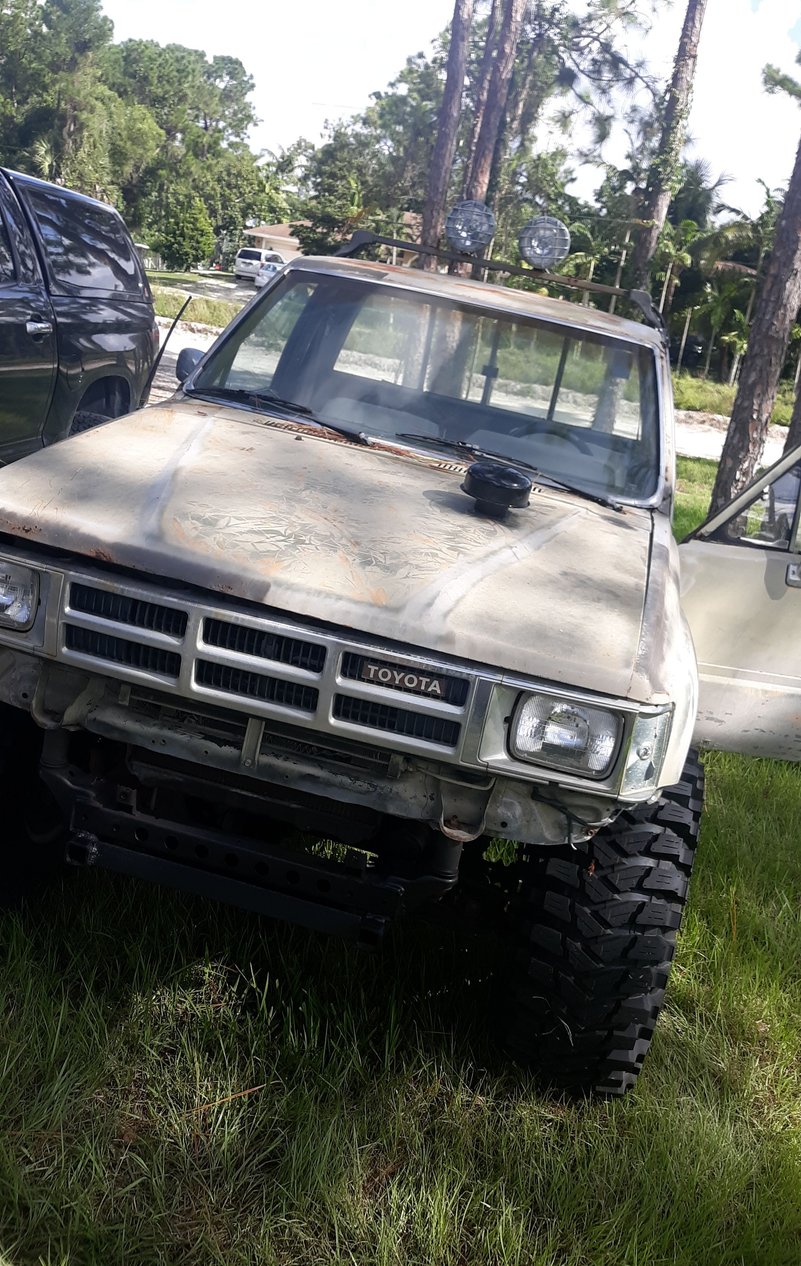

As it sits woth the treps

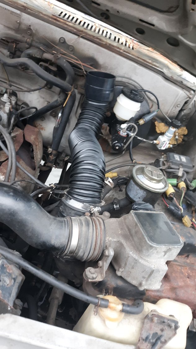

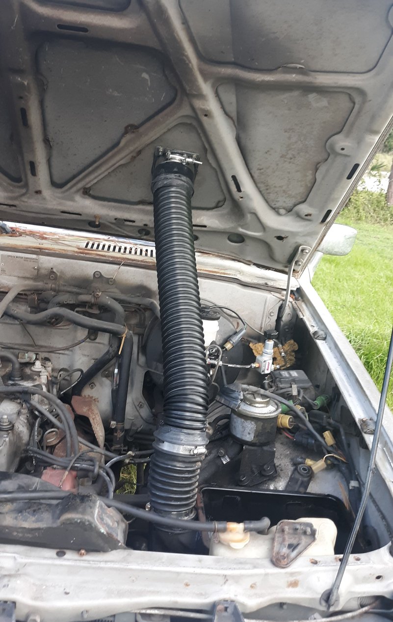

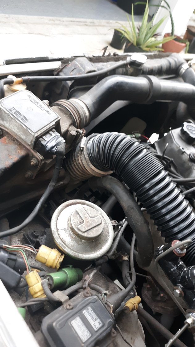

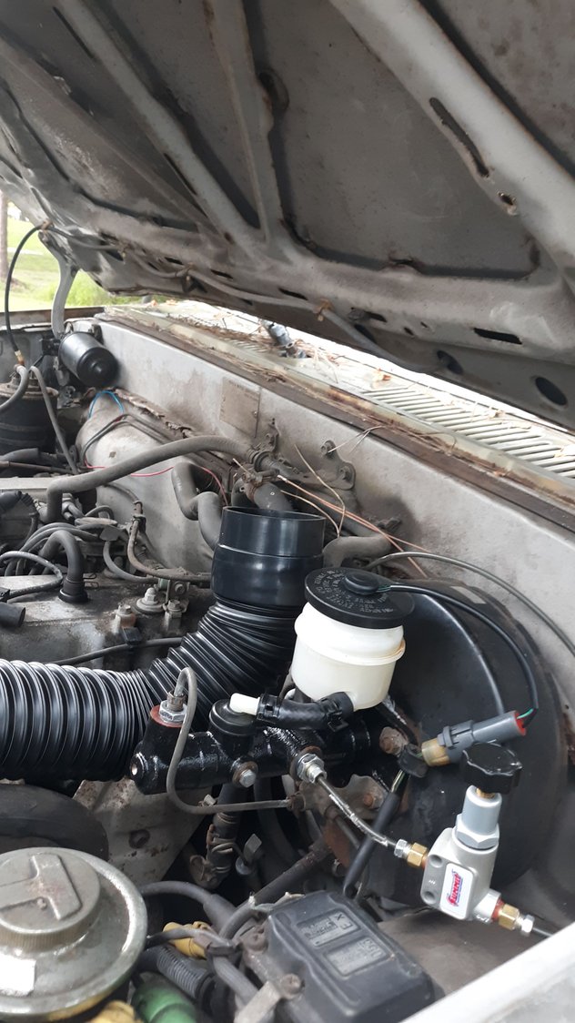

Got started on my snorkel today. I live in florida so when we do trail ride theres lots of water. So the plan is to run a hummer style snorkel. I ordered a top from river raider then grabbed some flex hose and some other pieces I had laying around. My air inlet (the part right behind the grill that goes into the bottom of the airbox) was trashed and held together by ac vent hose. So I cut it down to make a 45 and mocked this up. Going to silicone everything up once the top piece gets here.
Obviously doing breather hoses, the distributer, dialectic grease and a list of other things. This is more preventative as I really cant stand water crossings and mud. But it is what it is.

all finished. Just in time for this hurricane.
