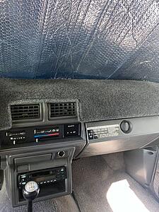

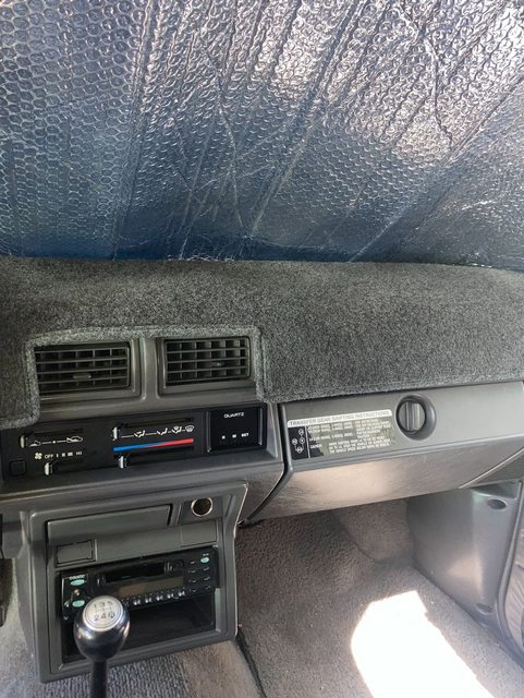

Hi there, I know it is a big project but I really need to get some AC going in my 1988 22re. I've done numerous engine/tranny swaps - replaced the heater core on my '88 so I am certainly capable of doing this job but the only thing stopping me is finding the correct parts. I'm transferring to UC Davis in the fall and will be living there for the next 2 years so I really could use the AC while I'm down there. The truck in question is a bone stock 1988 22re and here is the current climate control setup:
I'm mainly looking for someone to sell me the parts off of a 1988 that did have AC, and I'm willing to pull the parts myself if the truck is a reasonable distance from me. In terms of finding a truck, it's nearly impossible without asking forum members here. Any Toyota truck these days, even if it is not running, commands a significant price. Pick n Pull doesn't seem possible either, I don't see any old Yotas going in the yards anymore. So if anyone has a lead on a 1988 parts truck with factory AC I would be so stoked to get those parts. I will likely have the hoses redone and new compressor, condenser etc.
As far as the interchangeability between years and models, I really have no idea what to look for, I have seen that the wiring is slightly different though (depending on the year). So if anyone has information about that, I would be super glad to hear.

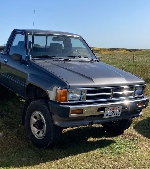

Here she is, originally sold in Auburn California. Not sure why it came with no AC, must have been much cooler back then in that part of California. Now, not so much!
