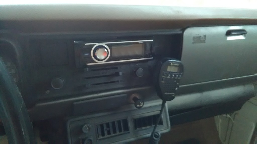

This is the only picture I have right now and its of the inside
The A/C Unit runs clear from under the glovebox to the side of the vent. There are two knobs, the top is fan (hi/lo/off) and the bottom is thermostat. Under the glove box there is the cooling coils and a squirrel cage blower. There are also vents on the bottom and sides you can't see. Underhood is just the normal stuff- compressor, dryer, hoses, condenser. Honestly I have no idea where the CA emissions end and the a/c kick up begins lol. As far as the wiring, there is a wire splice from the heater control that runsto the a/c controls, and then the wire to the compressor clutch and blower fan runs from there.

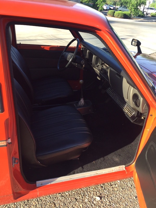

^That AC looks different than the ones I've seen in pre-79 Hilux trucks. They all looked like this one:
Seems to be a standalone unit that works independently of the heat. That's what I interpreted all the aftermarket universal kits to be - I was just going to take a look at what's available and size it according to whatever will fit under the dash in this spot, there's a good amount of room there!
For these kits I figured install is straightforward: Install your compressor, AC condensor, inside cab exchanger, hook up power to everything and charge it
