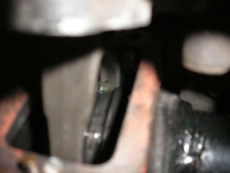

heres a close up of the ring that slides over the gear to lock the 4wd. there is a fork on the actuator that slides on the ring and moves it over the gear. but, unfortunately, the vaccum doesnt work and that is why i did the manual hub conversion.
you just slide it to the side with your finger.

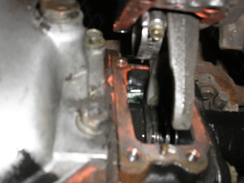

this is what i did to keep the fork from moving back to the unlock position. that way, the 4wd stays locked all the time, and you can just lock, or unlock the hubs to work the 4wd.
putting the actuator back on. make sure to line up the fork so it slides onto the ring. (i tightened the hose clamp before i installed the actuator)

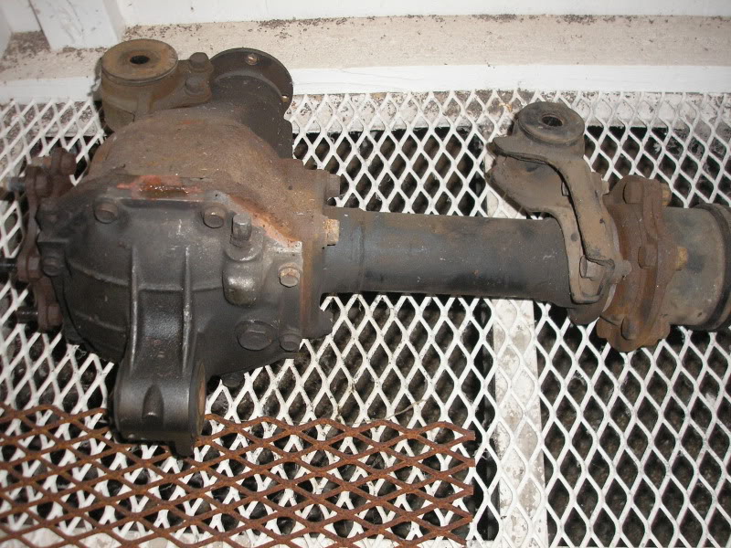

and heres a picture of the Non-ADD third member. notice it doesnt have all the actuator crap on it. this is why everyone says to just swap out the tube when doing the manual hub conversion.
compared to the ADD.
