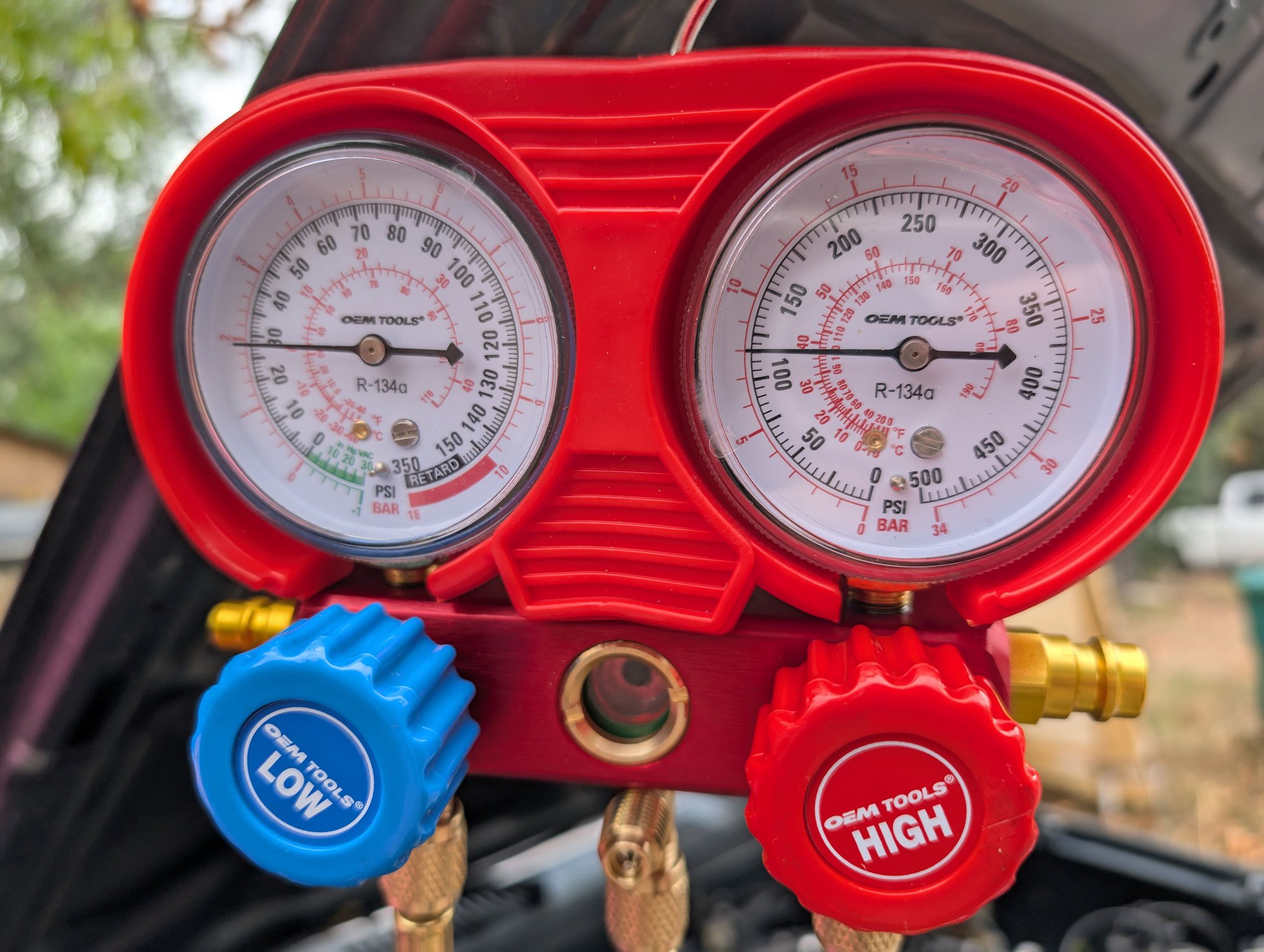

Yeah I think 28oz is the max. Here is a picture from when I was just refilling it, but then the high side was rising past like 250 and it was 70 degrees out, and I didn't know how much was already in there so I just vacuumed everything out and started over, that's when it started going to -25 on the low side when trying to fill it.
