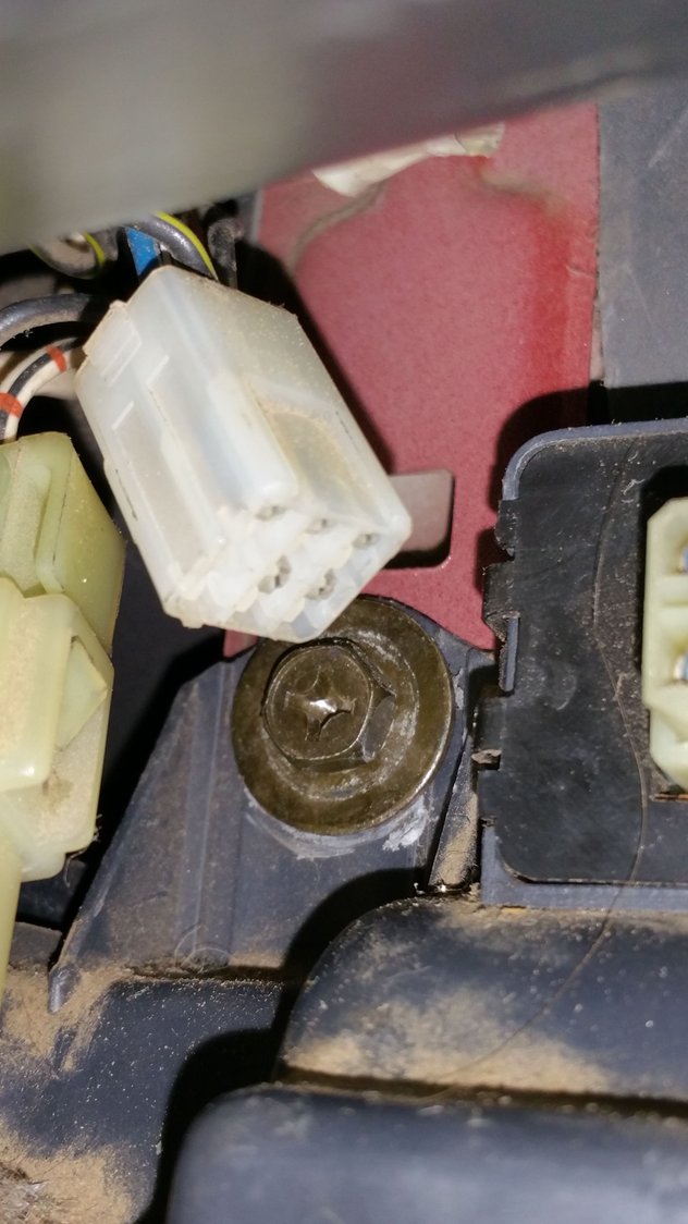

Here it is all together:
Found your connector:
That other one up top has three prongs.

Is your truck a 22re or 22r? Thank you so much for the pictures

Mine is 1985 22RE

Thanks for the quick response mine has a different conection right there

Looks like you need to source a connector and do some wiring. The FSM has a wiring diagram. It changes sometimes year to year. You could look at the colors in the harness for your truck and in the harness for the year the A/C came from and compare to see which pin should go where.

Well it looks like I may have found the problem. The place I ordered the whole ac system from pulled it from a carb truck and not a fuel injected one. They are going to send the right parts out monday. So I hope all goes well. Thanks for everyones help

I think it's a year difference too. I don't think it is carb vs EFI. I'm EFI and have the connector in question correctly hooked up. I'm thinking it's early vs late that's the issue.
