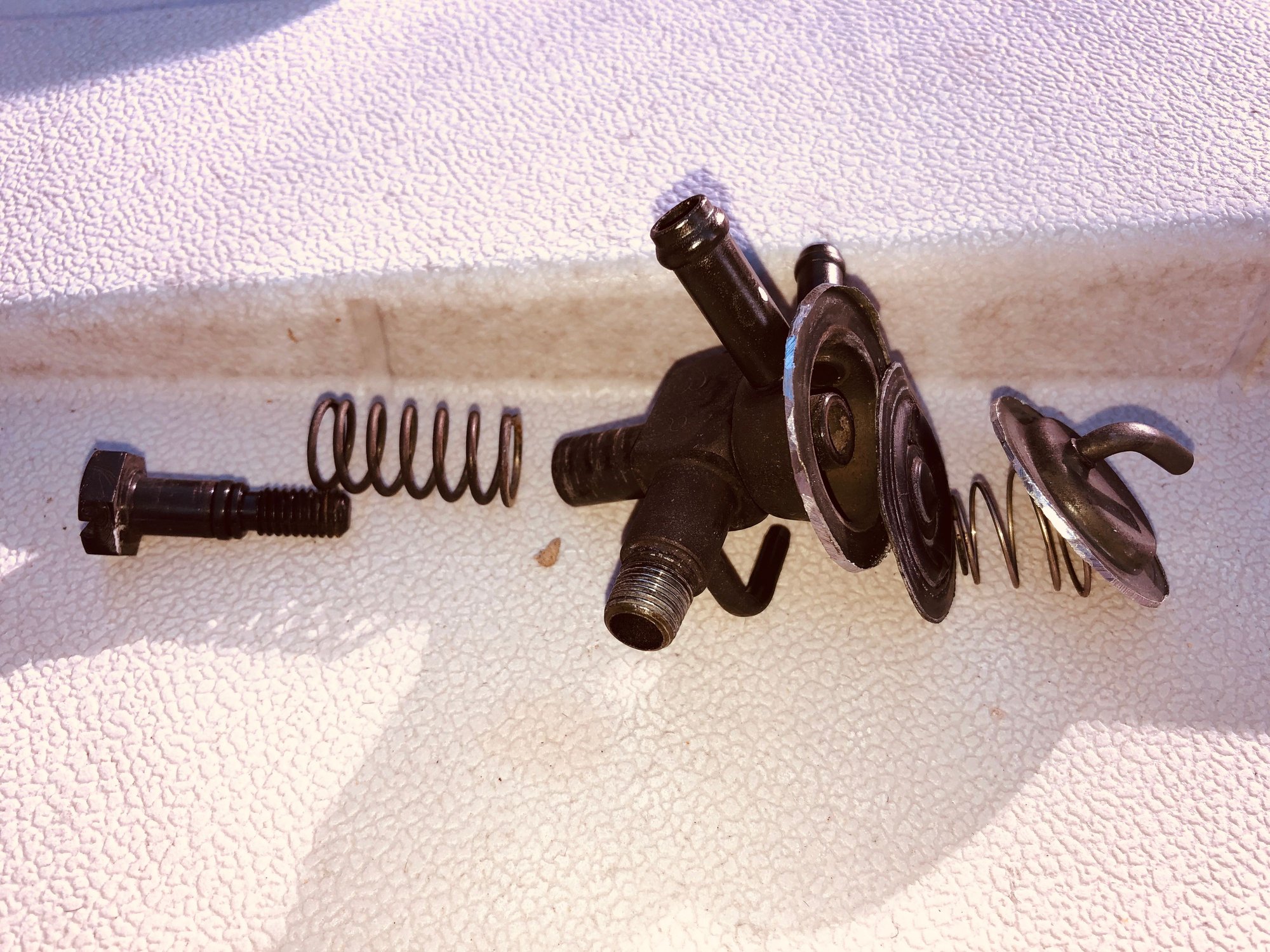

Inside of disassembled actuator.
diaaphragm cracked
Donor Part
Donor part
Old diaphragm on left (Spring side). New on right from donor part
Old diaphragm on left (Port side)
4-40 size allen head stainless steel bolts, nuts, lock washers, flat washers
Use one of flat washers to align drill, Using needle nose vice grips to hold everything together
complete. Later I had to turn two of the bolts so that they inserted from bottom otherwise the bolt ends hit the cold start injector when I screw actuator in
installed and works like new.

I took a gamble that Toyota would use a standard thread on all these diaphragms. Luckily that turned out to be true. There are a couple other diaphragms from old Toyota models that should also work, but this one was the cheapest and had the inputs/outputs in the closest configuration to what we already have. But your way is the only way I know to have that original look!
So now people have alternatives to the used Ebay part (don't know if it even works part), and depending on what they want, original look (but with some bolts) or your alternative with the T fitting and minimal modification to hoses, there is a solid fix. I just looked at Ebay and see original used part being offered at between $65 and $110. Crazy! The laws of supply and demand at work. Your alternative part can be purchased for $17 plus shipping (new) and used as is or scavenged for the new diaphragm to rebuild existing one or purchase the part I obtained (new) to also scavenge the diaphragm for about $11 plus shipping. I think those Ebay prices will come way down now once people learn that they don't have to pay those prices, especially for a part that the seller probably does not even know how to test or a way to confirm the condition of the diaphragm inside. Just have to get the word out about these fixes (Toyota Pickup Truck A/C air conditioning idle up bypass actuator diaphragm sub-assy cooler). I think that covers enough words for a search to capture. If there was enough demand for the discontinued part, a company such as Airtex Wells or other company could manufacture aftermarket replacement part. I would bet though that there are thousands of units of NOS parts hidden in some warehouse somewhere in the world. I doubt I will have my truck for much longer anyway. I have a backup part just in case. If it was 4x4 I might keep it for longer. It is useful on occasion with a high ARE fiberglass cap and its extracab DLX with 5 speed. Its been in Florida all its life near ocean so it has rust. It was difficult for me to find good quality tires for it too. Its not a popular size anymore (P205-75-R14). Not putting money into other size rims. I can buy trailer tires that size all day long but I cant put trailer tires on my truck. Anyway very excited that this thread is helping people get their cool on again while idling at the light.

Since I couldn’t get the proper part anymore, I got the Toyota part 88606-32010. The larger vacuum port is pointing 180 degrees the wrong direction, so I tightened it a little short. No leaks and I can use the stock vacuum lines. If it had leaked, I would just put a couple of wraps of Teflon tape on the threads.

Hi Bmxracer50, I don't think its a problem having that part upside down. might be difficult to adjust. Do you have power steering? I see a vacuum line running into the intake planum just in front of that part. That is coming from power steering right? Normally there are two lines coming off power steering idle control valve that is mounted on power steering pump. Where is your other line? I think you need to set it up like TLfromAI did with the "T" fitting. See his pictures in this thread. Other wise your power steering idle control valve won't tie in to filtered air from in front of throttlbody to make the idle increase when power steering is under load at idle. That is of course assuming the power steering idle control valve is working in the first place.
