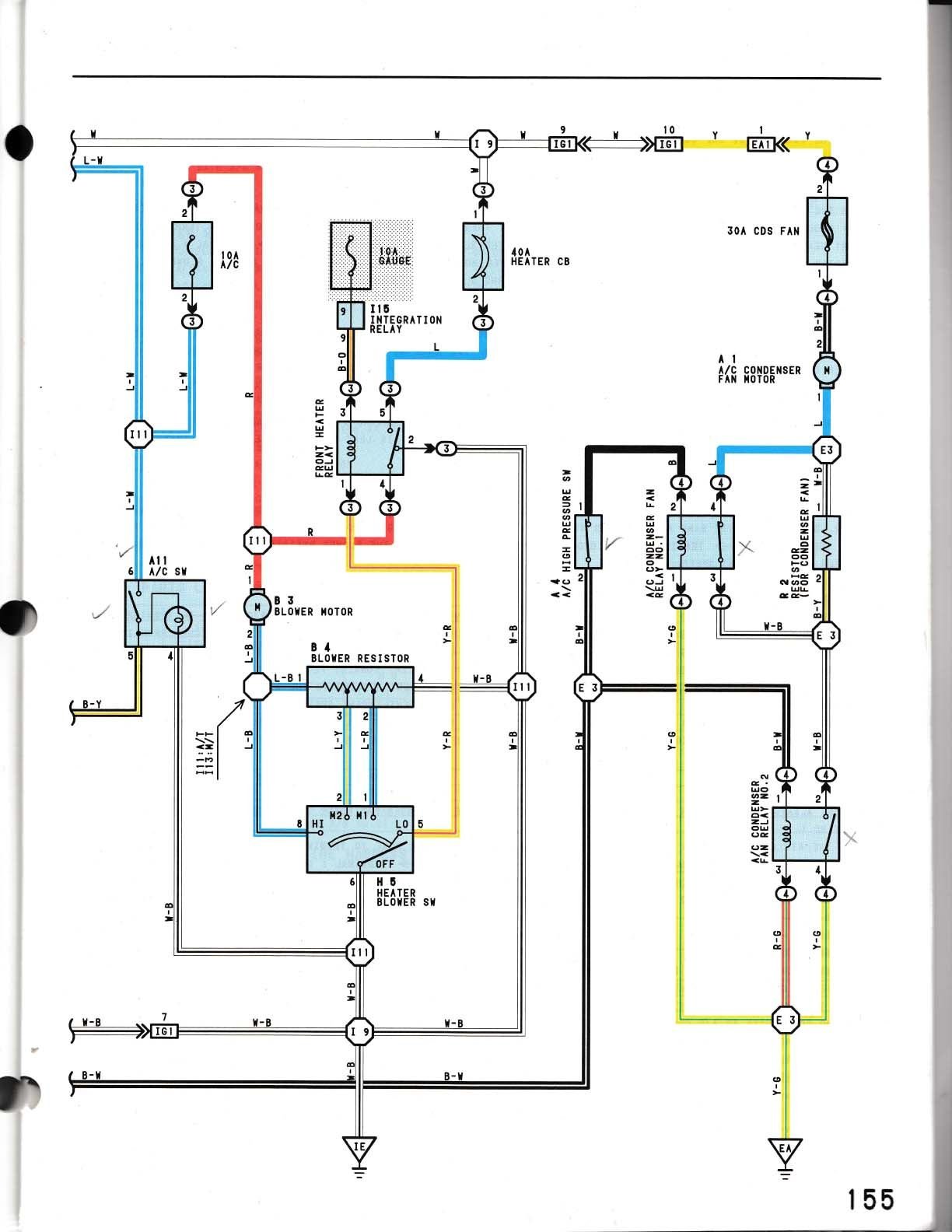

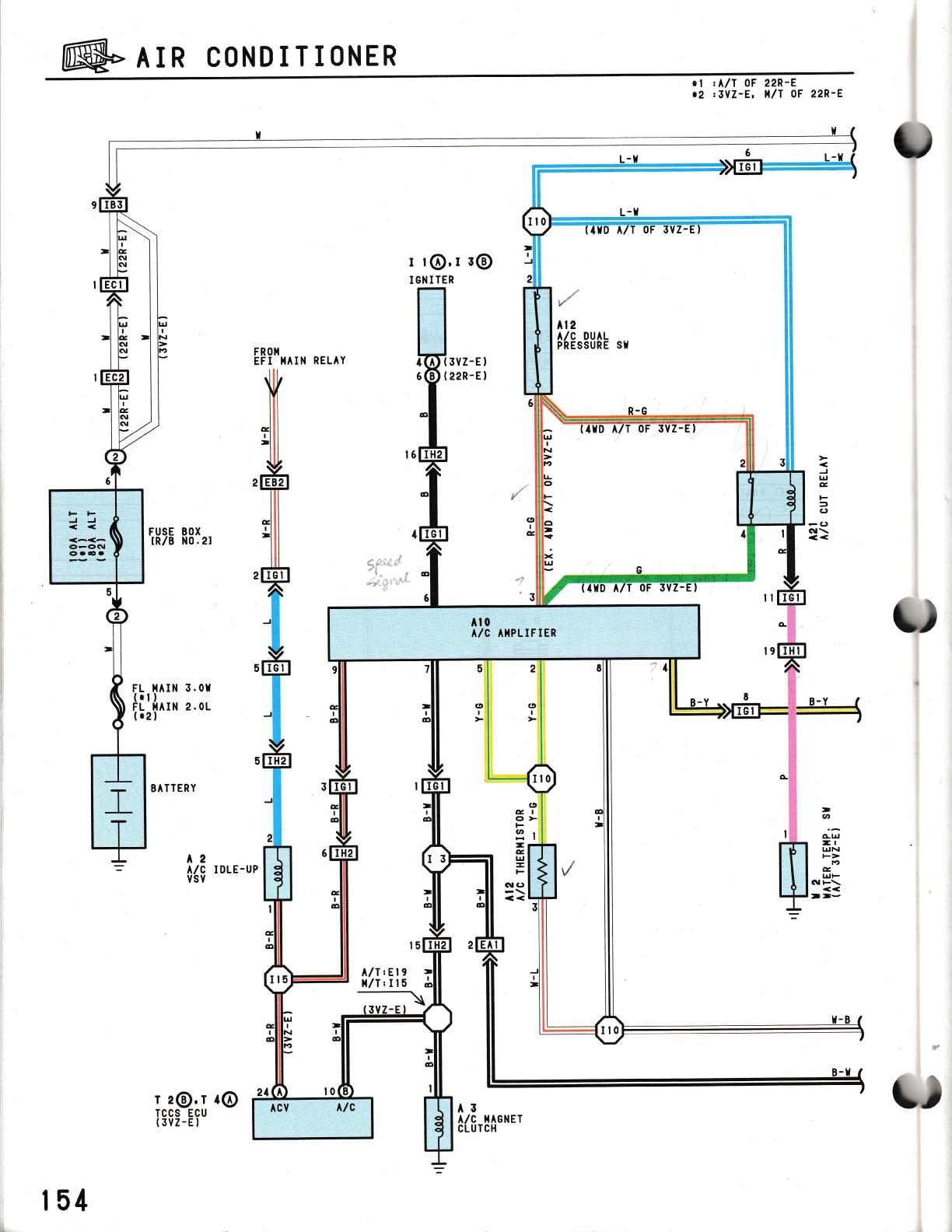

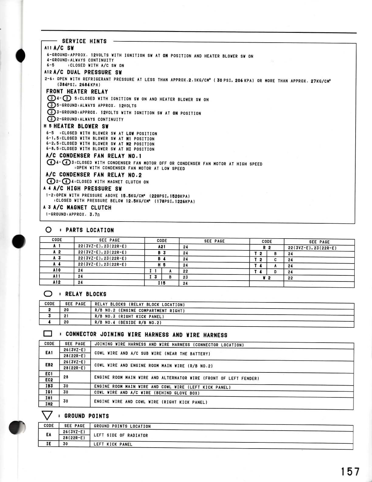

You didn't mention if/when it last worked. If it has not worked for a while there are many other possible issues. My recommendation, unless you are familiar with AC systems, is to take it to a recommended shop and have them do a quick test of system pressure. If that shows empty, then a vacuum test to check for leaks. Depending on what that shows you can decide how much you want to spend. There is also the R12 or R134A question. Do you know what it was previously filled with because they are not compatible.
I have attached the schematics for the system if that helps troubleshooting.
Good luck!
Jim
