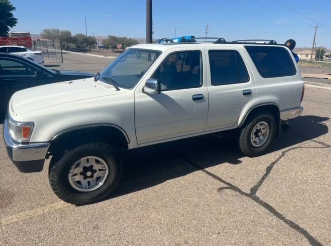

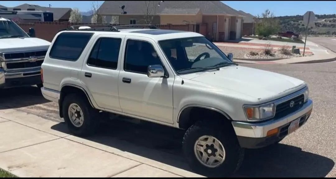

Yes. Automatic or manual? Almost sounds like it was used up off road rock crawling or something. A pic of the truck as well. Maybe it has all the telltale add ons like a winch.

here's the truck, it is an automatic. Carfax does confirm original miles
