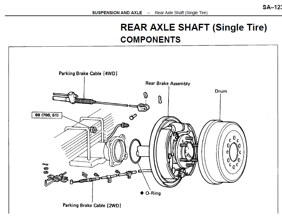

Can anyone comment on the o-ring placement? The FSM seems to show it going around the axle housing or bearing. Thing is, I don't see an old one on my vehicle unless maybe it decomposed....?

In the picture I posted above, the 0 ring is around the out side edge of the axle tube. You can see it if you look close.
