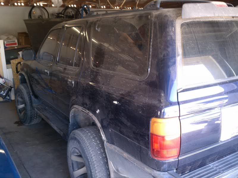

here it is! a little dirty, but in great shape
