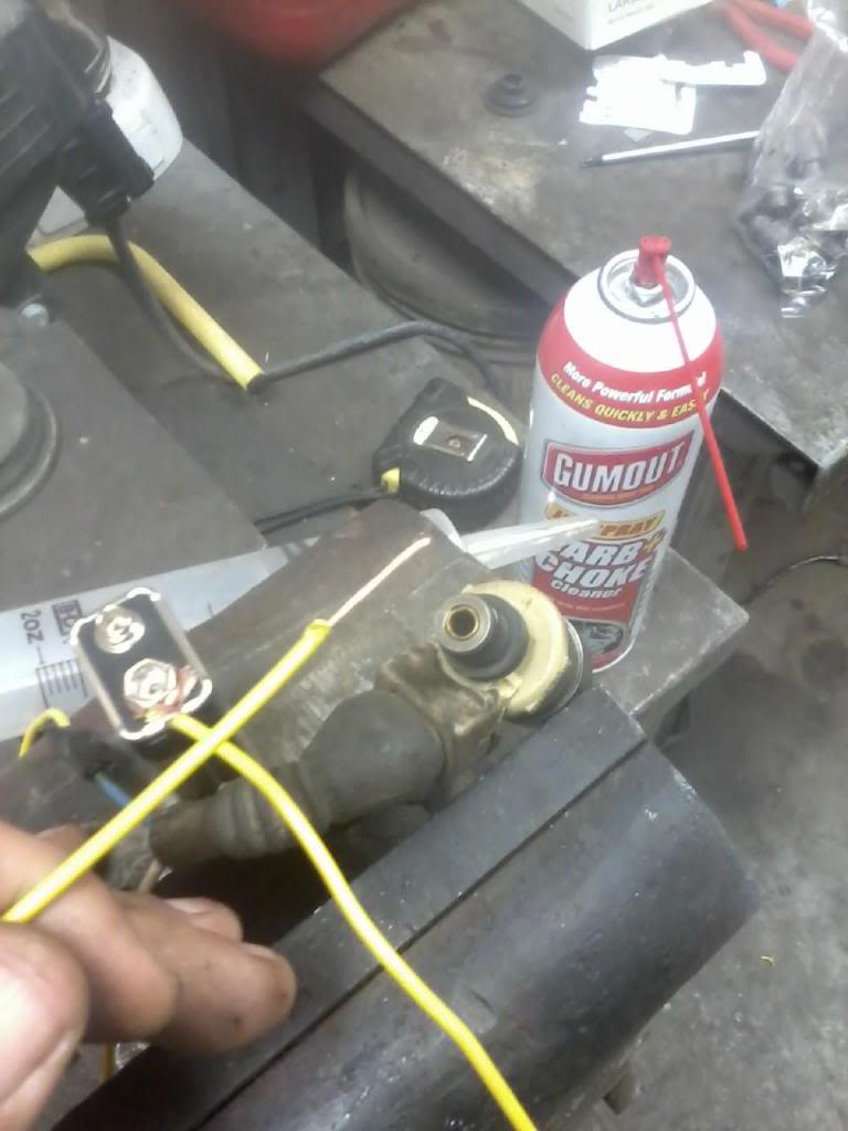

I took a syringe, a rubber hose and a 9 volt battery and with a 1 second touch to the battery, it would flush the Gumout thru the injector. I had a spare/junk harness and used a connector off of it, but alligator clips would work as well. I got my new injector connectors from connectorsfast.com I have a set of Flamethrowers injectors and like his real well if you are going to replace them.

Thank you Terrys87 for the tip on cleaning the injectors yourself, but I still don't quite understand the cleaning process, can you please elaborate? Did you use the syringe and hose to safely get the Gumout cleaner into the top of the injector and then connected the injector to the battery to make it inject/spray? I'm assuming the cleaner should not get into the connector of the injector. Do I need to use a 9 volt battery or can I just use my car battery? Also, any suggestions for testing the injection of the injectors as the FSM prescribes without purchasing the SSTs? Mahalo for your help, it is greatly appreciated!
