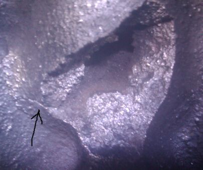

So i am working on rebuilding my 1994 22R-E and i pulled the engine stripped it down to a long block (bottom end still together as well as the head and rocker arm cover.
in removing the exhaust manifold i noticed a problem. it appears that there is a chunk of metal missing from my engine block.
This is located just to the rear of #3 cylinder and it is below where the head bolt goes in. you can see the bottom of the head bolt through the hole. there is a crack which seems to be spreading forward...
If all goes correctly there should be an image right here:
I also know the head gasket was done by an amateur mechanic about 2 years ago... could he have over tightened the bolt???
Basically my question is can i still use this block?
or do i need to replace it?

if i were you i would get a new block because i looks like one of the head bolts wont be held in securely. i would just get a different block so you know that once you bolt the engine together you wont have to take it apart for a long long time and dont have to worry.

I probably wouldn't keep it. That head bolt may never torque down right, or it could finish off the failure. Looks like someone ran the bolt to the bottom, and over torqued it. You should be able to find a shortblock around for not too much, and put all your internals in it.

I would hunt Craigslist, or local pick n pull type yards. For a bare shortblock, I'd say about 3-500 bucks. Or source a longblock, and mix and match their parts and yours. Selling off the unneeded parts could recoup some of your money spent, too.
Note: did you have a head gasket leak, or any evidence of one at teardown? It may still be ok...
