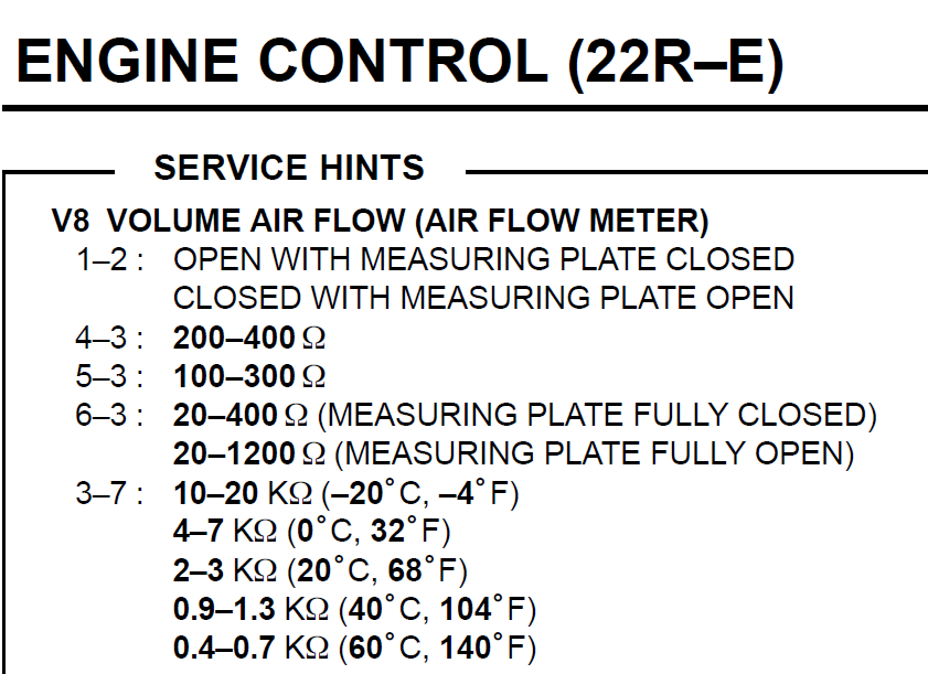

This isn't the way to fix it, but if the fuel pump isn't running, you can jump FP (fuel pump) and B+ (battery power with key on if I remember right) in the diag port on the engine to force the pump to run. If it stays running, then there's an issue with the things that tell the fuel pump to run. I don't work on this gen truck too often, so it's mainly based on the older pickups.
I pulled up the wire diagram, fuel pump is switched on the power side by the circuit opening relay (fuel pump relay basically), and the relay is activated by the starter relay at crank and as soon as the engine runs, the air flow meter closes the circuit to keep the pump on while the engine runs. Here's the test procedure for the air flow meter, the main test we are interested in is the pins 1 to 2 test.
Here's a photo of the connector/pin out, on the actual air flow meter the pin out will be backwards (right to left).
