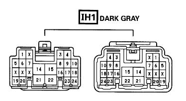

Here is the FSM section on testing the computer, to jog your memory maybe. You said you did these but obviously you had to of failed the ones that require the engine to be idling or hot.
Yes "left hand kick panel", I don't know if the kids were down that far to have disconnected or loosened it. Do you have the service manual? The 1990-1995 4runner one has all the nice wiring diagrams with pictures of where things are, they're not fancy 3d but they'll get you to the right area atleast.

Ok i got to the IH1 gray connector
the violet wire (purple) is on #3
#8 is a black wire with a red strip
i tested voltage on all the pins and slots and all are 0.00 volts to 0.02 volts
this truck is a manual trany 4x4 does that make a diffferance??
am i to take it that this wire i am looking for should be at 12 volts??
so since there is no 12 volts in this connector
what is the next step of pain and fustration??
