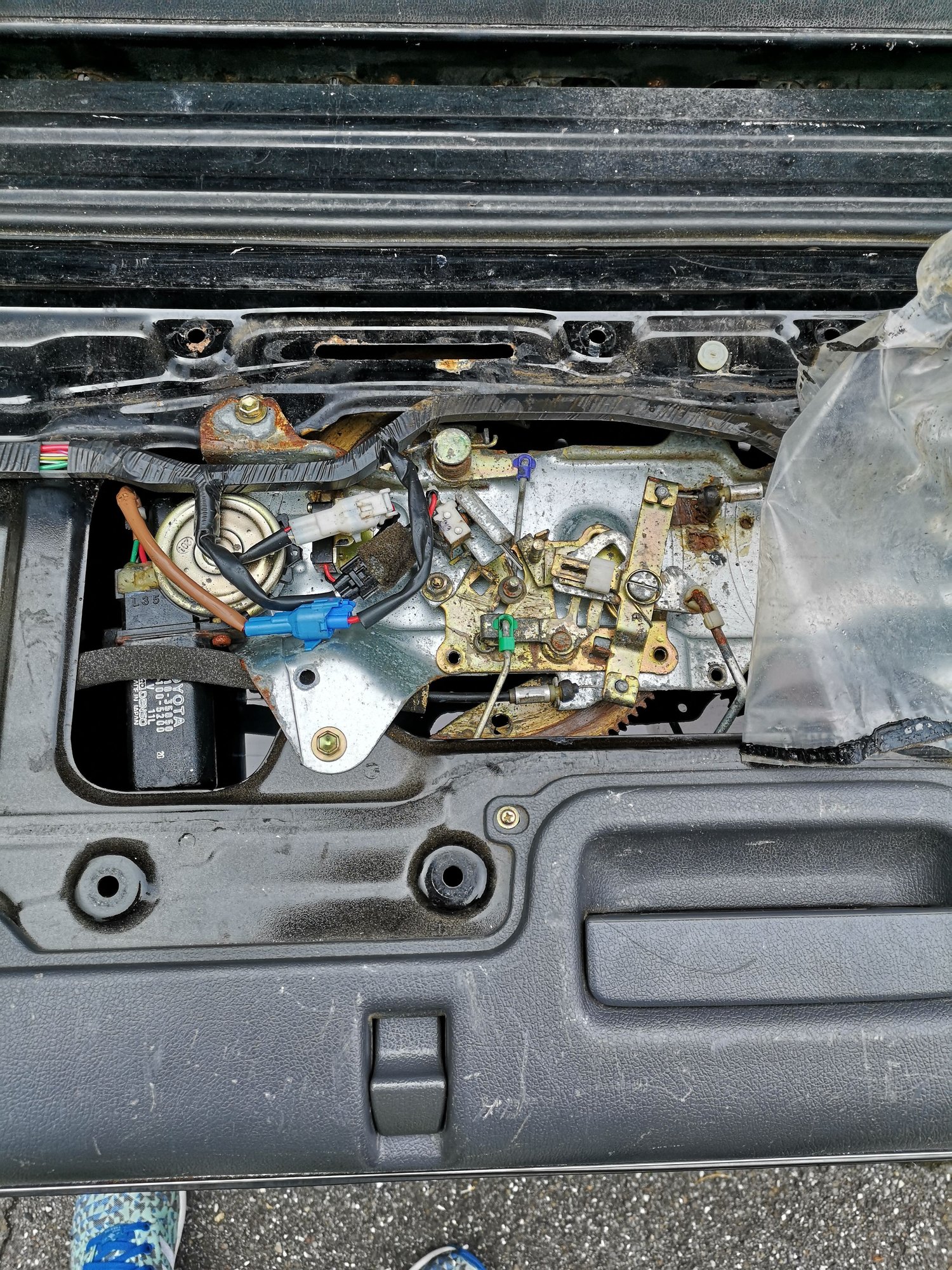

i have checked the blue connector that goes to the motor (on the pic) which gives me 0 or 12V depending on how i turn the key. i had this issue in the past, but about 10min later it worked again fine.

Have you tested the motor independently of all the switches? when I was testing mine I connected two wires from the battery to the motor. When I connected the second wire to the motor it started moving, so I knew the motor was good. It sounds like you are getting 12v to the motor so it makes me wonder if it's the motor? If the motor works then you can bypass all the safeties and ground the switch to a separate ground and see if it works then?

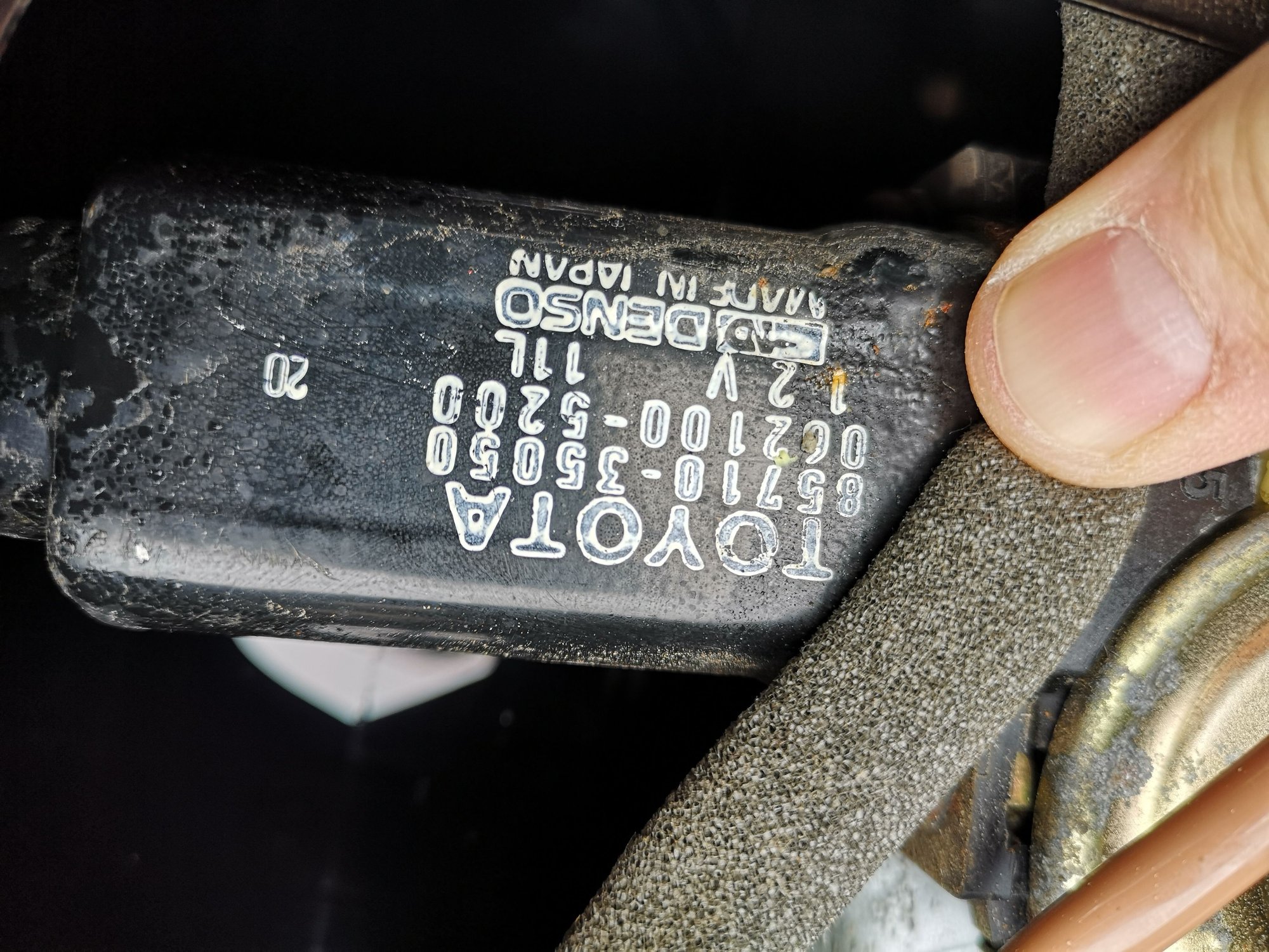

alright, we did test it. and it seems to be the motor. just ordered a new one off of rockauto (https://www.rockauto.com/?carcode=1272451&parttype=1516)
once it arrives, i will do the whole maintenance procedure according to this video as well:
