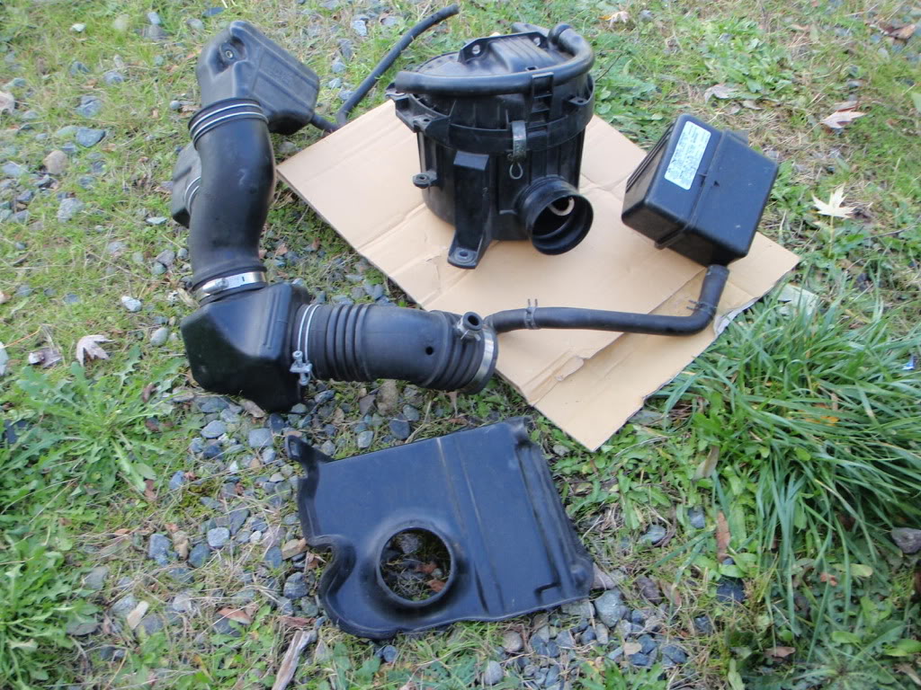

hey, need any intake parts? trying to get rid of my old intake and silencer stuff, did the ISR mod and don't want this stuff in the garage taking up space. thought i'd throw this in there in the off chance you need it...
