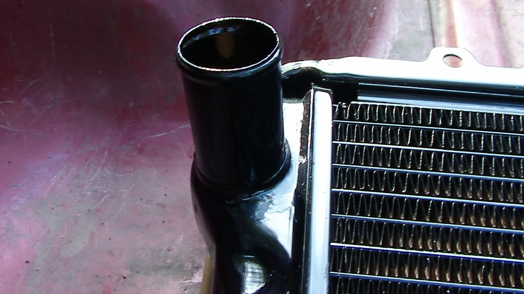

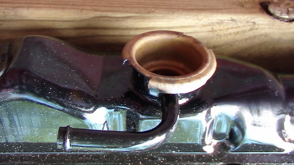

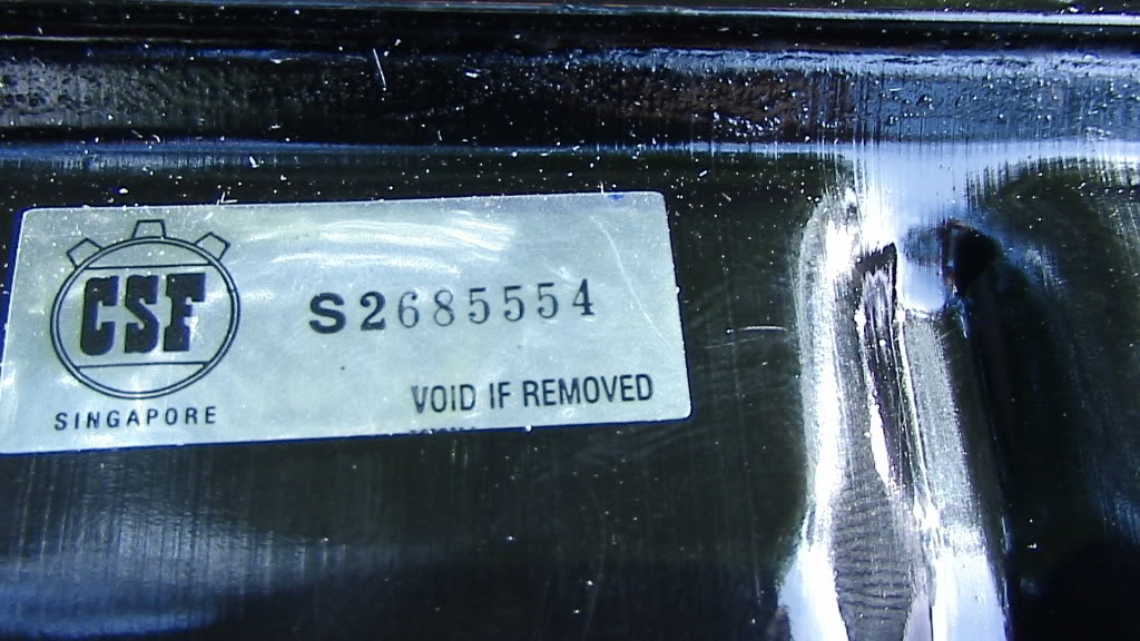

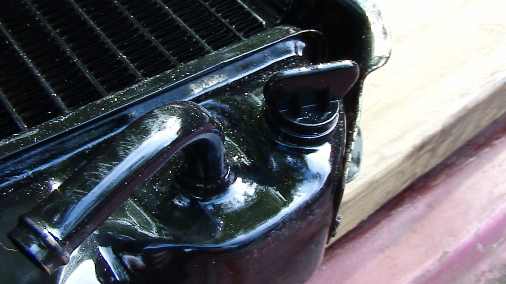

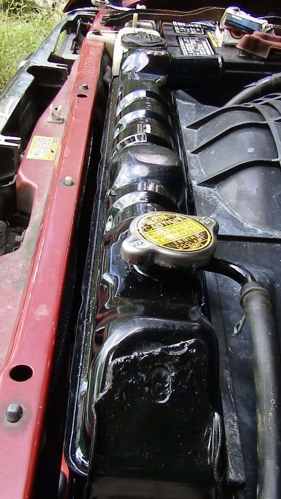

I finally uploaded photos of the CSF radiator I installed about 2 months ago; ZERO issue with it since then. It looked EXACTLY like the OEM except I had to hammer on the bottom support brackets of the radiator to get it to squeeze in between the frame rails. Overall, a VERY easy swap! Name:  DSC01985.jpg

The second, which was a mild annoyance, is that instead of the stock type drain cock, it uses this crappy plastic plug that has a relief hole cut into it. When you try to drain it you loosen the plug, and the coolant sprays circular as you loosen it, getting everything covered in fluid until you get it loosened and pointing down. The stock type flows the fluid out the center and is not affected by loosening. Of course, the pipe thread does not match between the two, so you cannot swap the stock one back over.

I paid $205 delivered to MD. And he was right about the crappy drain plug; it just outright sux @$$.

I put this same radiator (from the same place, for about the same price) on my '95 4Runner back in 2002. It's been great since then - around 60K miles later. Until 2 days ago....that crappy drain cock broke off for some reason. I noticed a little leak for a day or two that got big all of sudden yesterday. I tried to locate a replacement, but O'Reilly and Autozone (and NapaOnline) don't have one with those threads - M10x1.5mm. I tried a M10x1.25mm from O'reilly, but that still leaked.
For now, I've got a bolt/washer in there to plug it up. But I'm wondering if there will be any significant corrosion issues due to the different metals (steel/brass)
I've got an email into CSF's customer service to see if I can get a replacement that way...we'll see. Nice radiator otherwise...

No problems with fit in my 86 pickup, but that drain plug is extremely annoying. The factory radiator had a down spout, so coolant would drain down into a bucket. Very convenient. This thing is just a plug in a hole, and as mentioned sprays everywhere until you get the plug out, then it shoots rearward making it hard to catch.

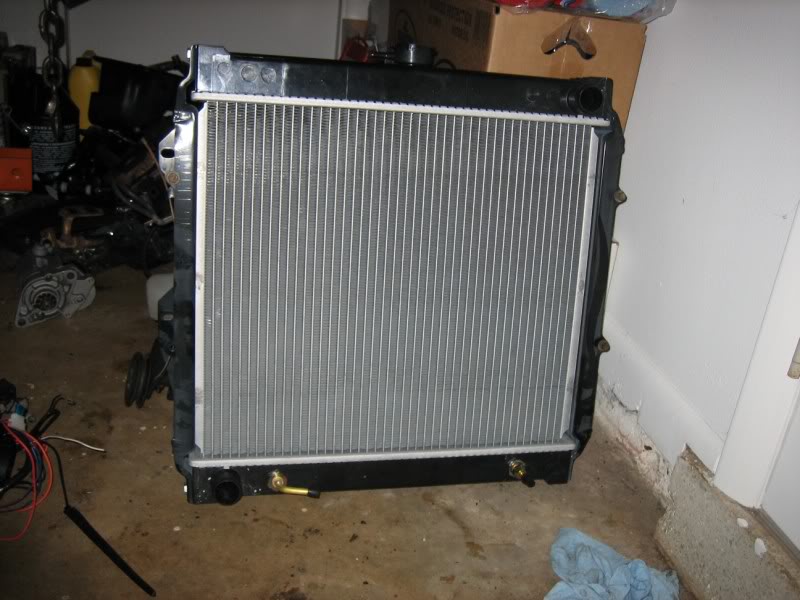

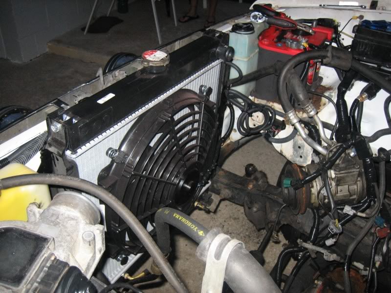

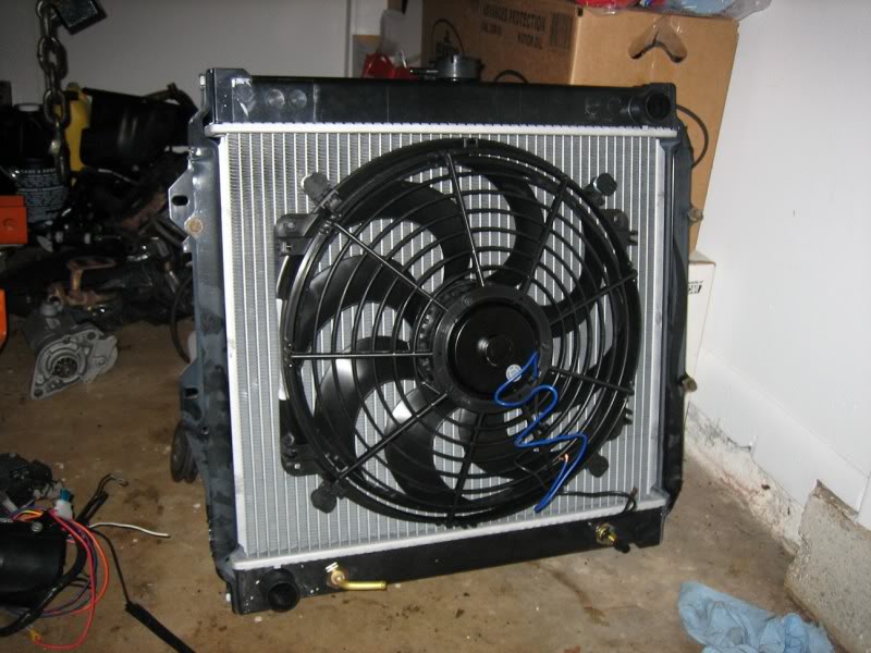

although I'll admit, I'm not a big fan of the plastic top and bottom... but it works...
