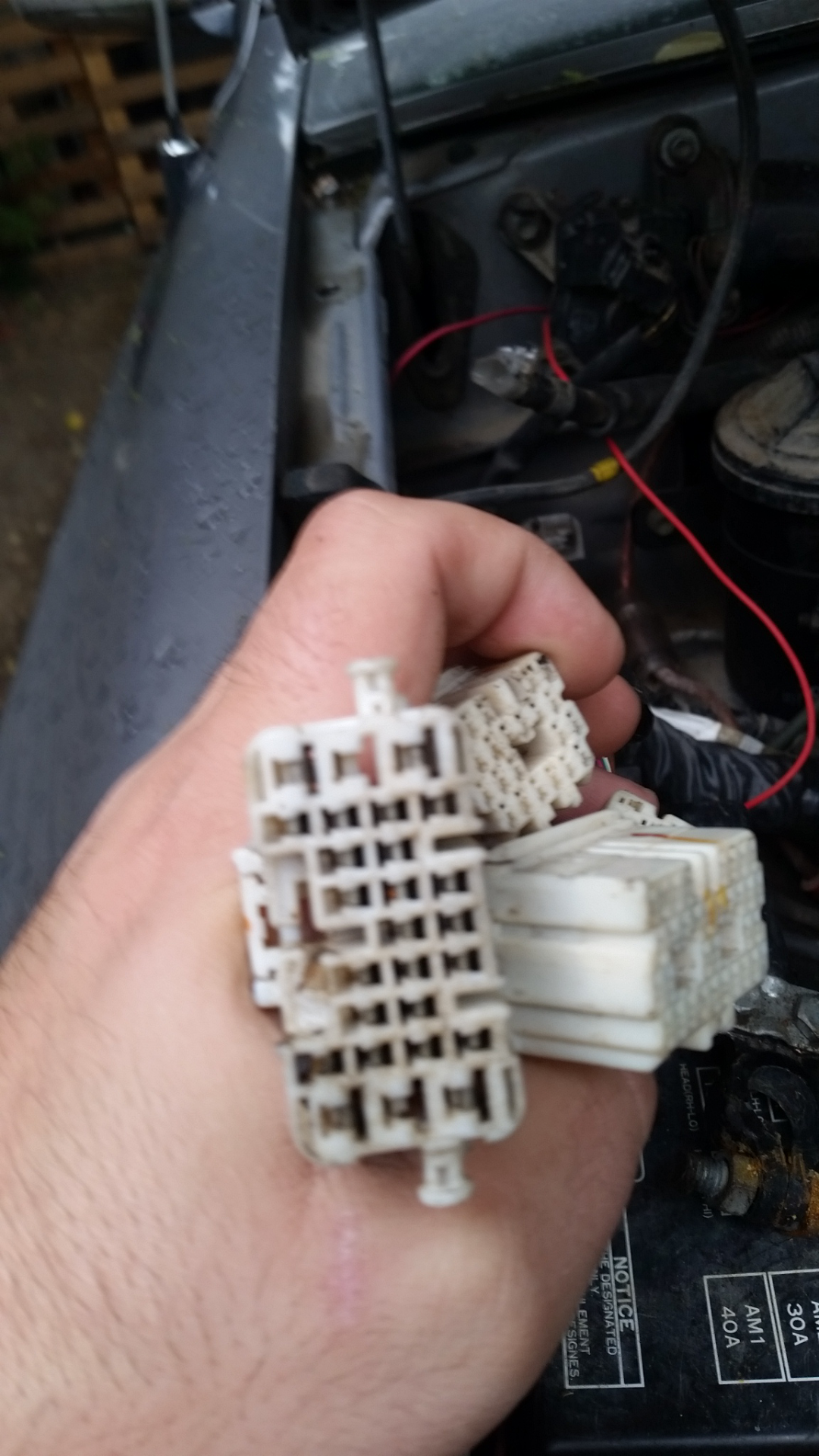

This is the connecter

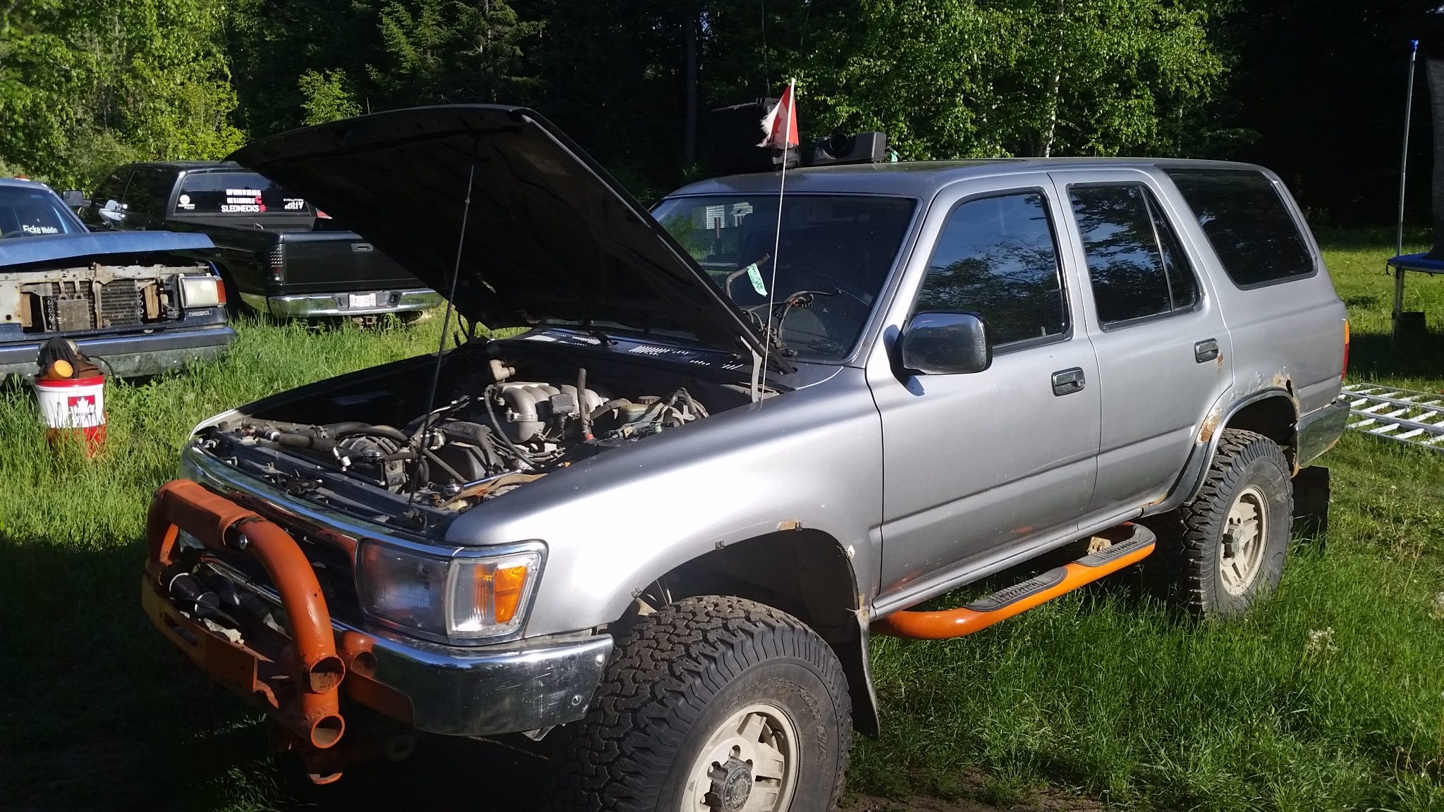

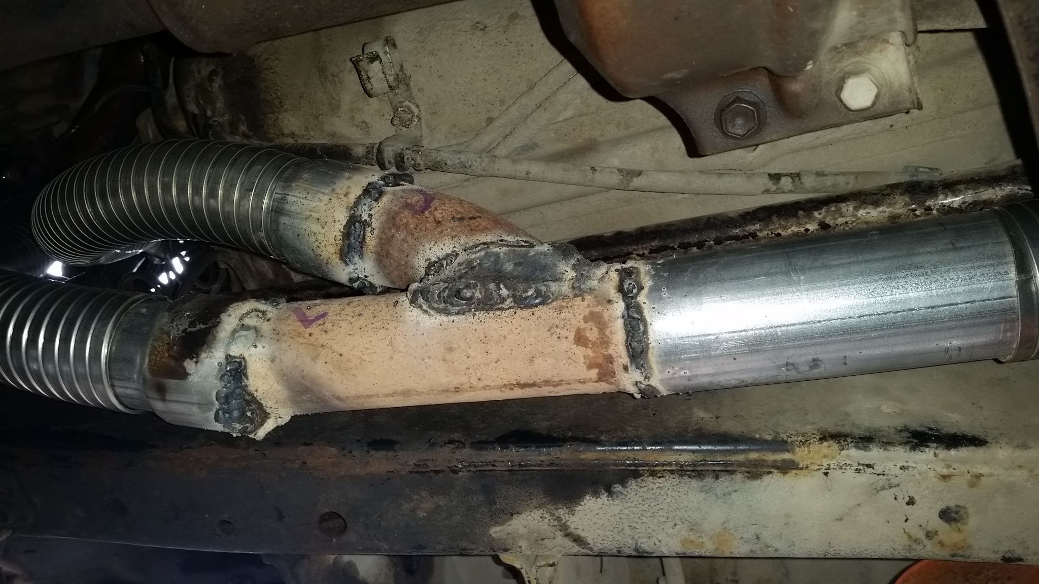

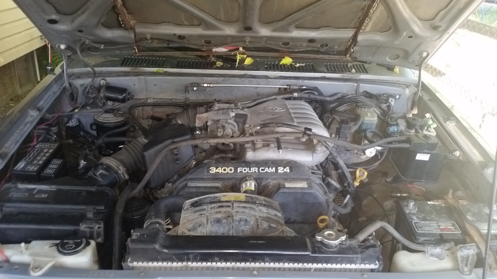

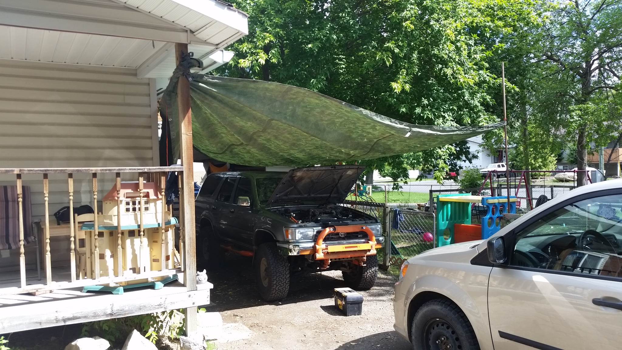

Here's a few pics of my truck the 3.4 and my exhaust
Attached Thumbnails 93 4runner 3.4 swap wiring help-20160603_161211.jpg   93 4runner 3.4 swap wiring help-20160529_183445.jpg   93 4runner 3.4 swap wiring help-20160520_151554.jpg   93 4runner 3.4 swap wiring help-20160515_180543.jpg

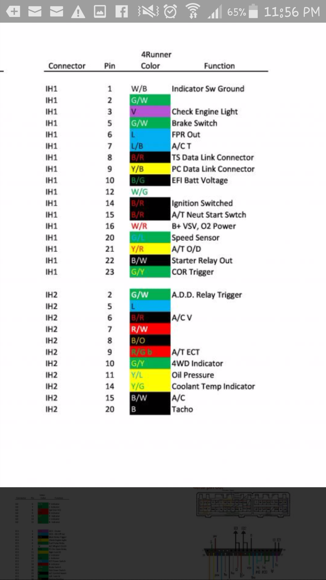

I have been tying to find a pinout like this one but for the plug on th t100 harness to the dash

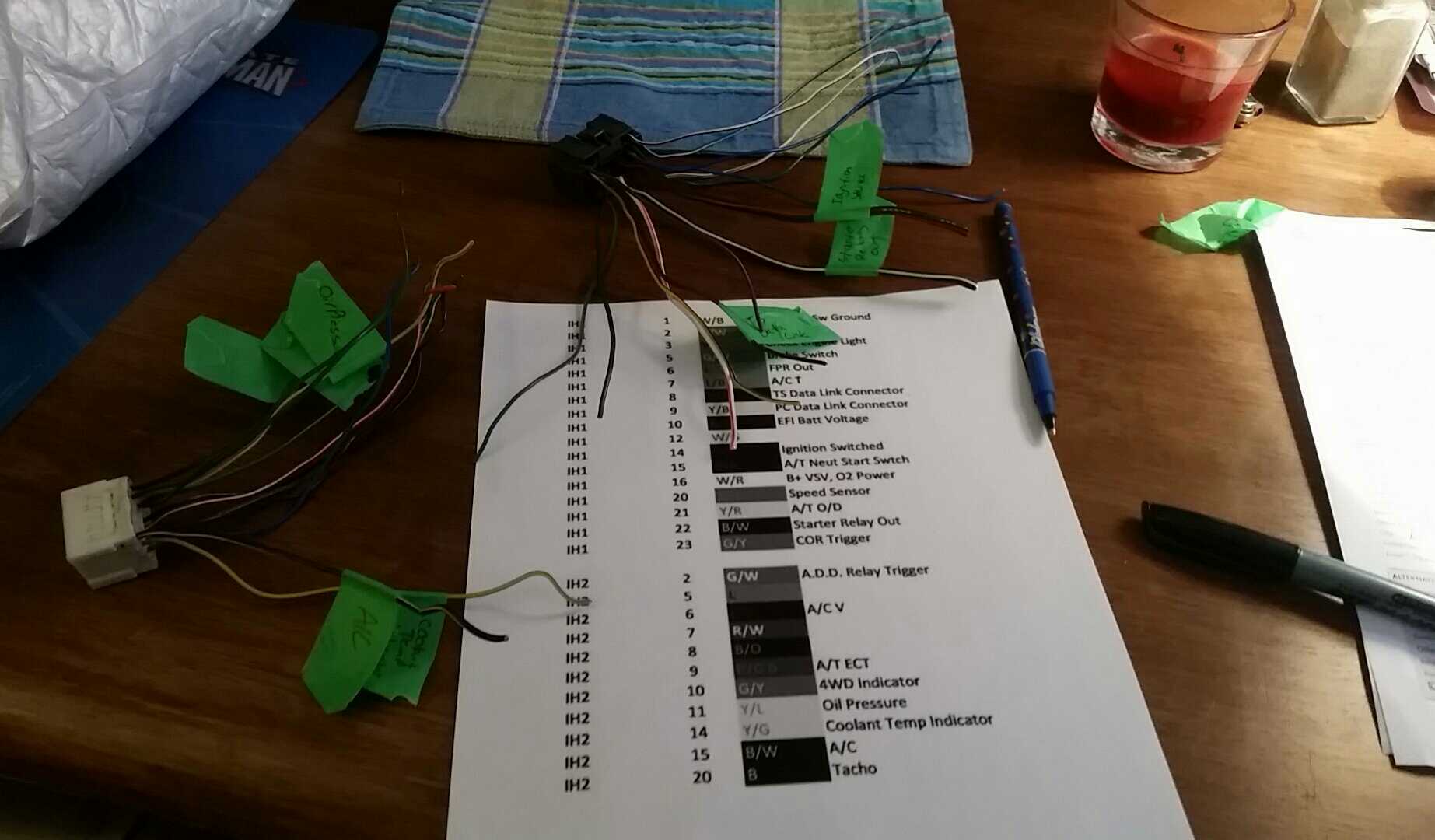

I have sat down and figured out all the dash wires for the plugs on my 93 4runner, just need to find some sort of diagram to help me identify the wires on this plug as all I can seem to find are ecu pinouts
