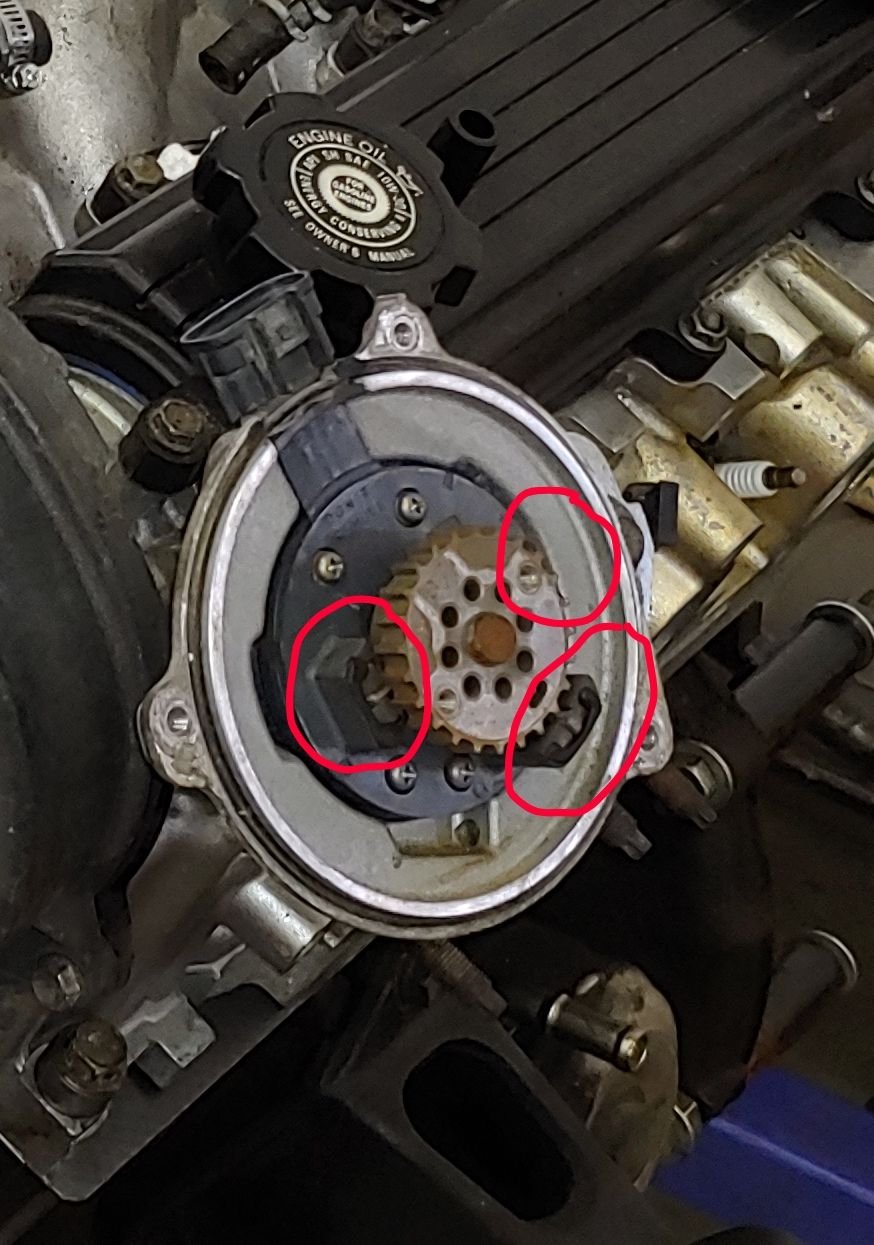

Originally Posted by Co_94_PU
Your initial ignition timing should be rock solid with the test jumper in place, check for play in the distributor rotors shaft and that non of the electrical pickup coils are able to shift. All should be very solid. I would normally suggest checking the high tension (spark) cables aren't wrapping around or too close to the signal wires but you say it's consistent at 3° fluctuations.
I have attached a picture of my distributor, can you tell me if what I have circled are the three pick up coil contacts? If so, none of them move at all. I don't see how you get the black cover off that says "Don't Remove" without removing that gear that the rotor button screws to. Maybe I don't need to, but I'm not sure how to inspect ant further. When checking the air gap, you are only looking at the contact that aligns with the teeth on that gear, correct?
Thanks again!
Old Sep 11, 2019 | 06:59 PM
scope103's Avatar
Joined: Sep 2007
Posts: 8,384
Likes: 875
From: San Francisco East Bay
Here's the section of the manual that you need: http://web.archive.org/web/201212070...12onvehicl.pdf
While you don't want the coils to move at all, "play" is usually in the distributor shaft (if at all). You should be able to push the reluctor ("the gear") back and forth without any movement. A small amount of backlash ("twisting") is normal.
