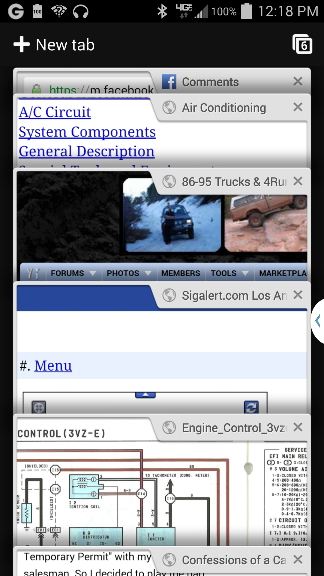

Finally, save this URL http://personal.utulsa.edu/~nathan-buchanan/93fsm/
If you have an iPhone or Android based phone, visit that URL from your phone and then take whatever steps your phone requires to "Save to Home Screen." This way, if you ever need to access the FSM from your phone, it's literally one click away. Each time you access the engine section, make sure you are viewing the 3VZE section or you'll likely find yourself thoroughly confused. LOL
