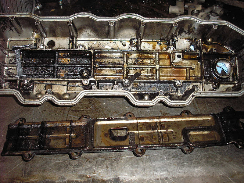

Originally Posted by Lumpy
Valve cover gaskets???? You think? I'm not so sure...
I know one of them is, and just thinking the coveritself has a little difference between 22r and 22re.

Likes: 17
Oooooo I see now...I didn't take that piece off.
hehehehe
you be right, I be wrong. Not the first time nor the last.

I never understood why toyota riveted that baffle on anyway with a wearable gasket underneath of it.

I've read that some valve covers (early ones, I think) used screws instead of rivets. Maybe they also had a different shape gasket.
