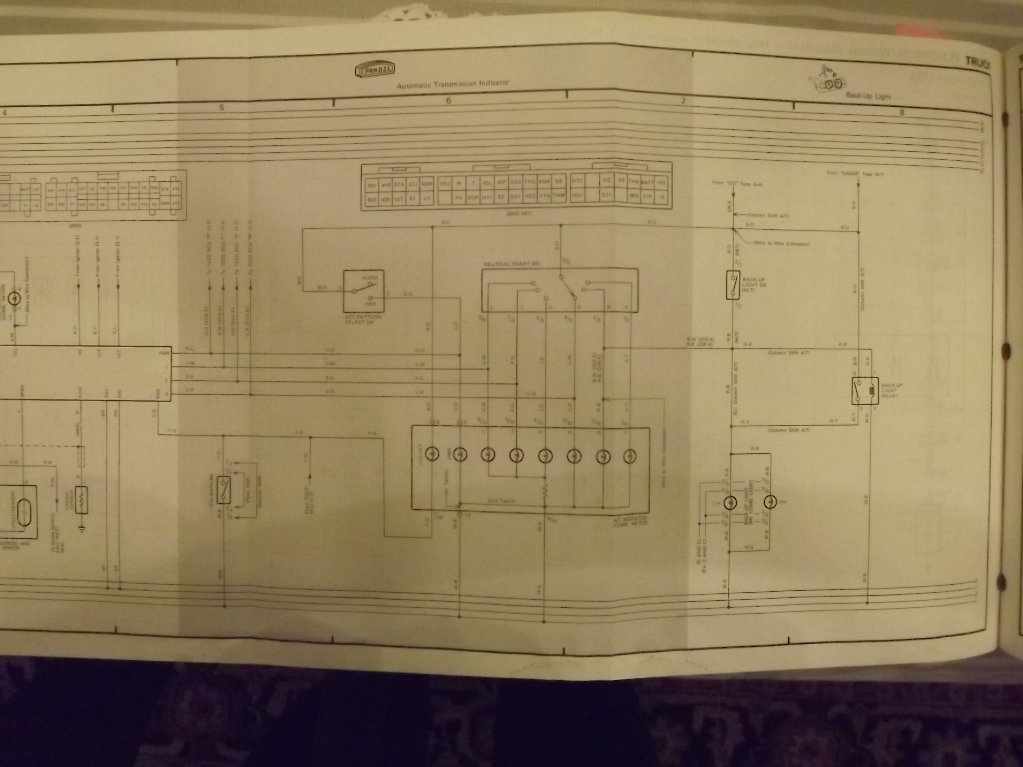

Cool! May I also suggest that u check your schematic to make sure the starter relay is wired properly? Relays on 1986 to 1988 22RE manuals were WIRED WRONG AT THE FACTORY.

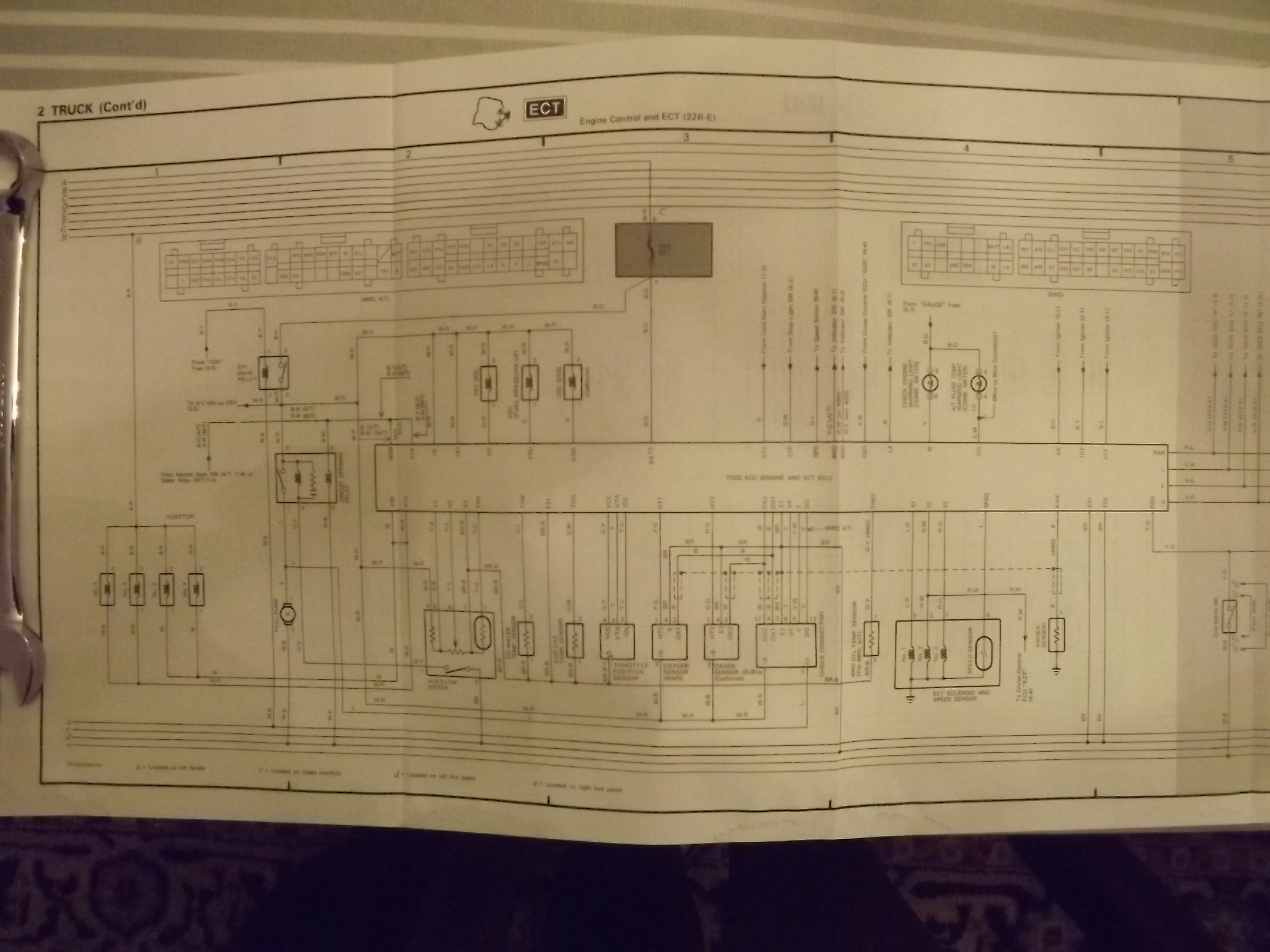

Originally Posted by DallasTX
Anything is possible, but I believe it is unlikely the 92s are wired wrong. I have been driving a '92 since '92 and never had issues with the starter wiring. ... I have the 92 FSM and can send you pics of the EWD...
Yes, please share the EWD showing wiring from ignition switch, to starter starter relay to solenoid.
Many people do not have issue with the the 1986-88's even if there is documented error (CLEARLY SHOWN IN TOYOTA SCHEMATIC) and many would not believe there is an error, because sometimes smooth mechanical operation, strong solenoid coil action and softer return spring mask the existing problem.
Old Jan 21, 2017 | 02:38 AM
DallasTX's Avatar
Joined: Nov 2016
Posts: 105
92 ewd
Attached Thumbnails 92 pickup Starter/ignition problems-dscf7469.jpg   92 pickup Starter/ignition problems-dscf7470.jpg   92 pickup Starter/ignition problems-dscf7471.jpg   92 pickup Starter/ignition problems-dscf7472.jpg
